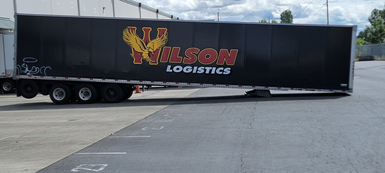

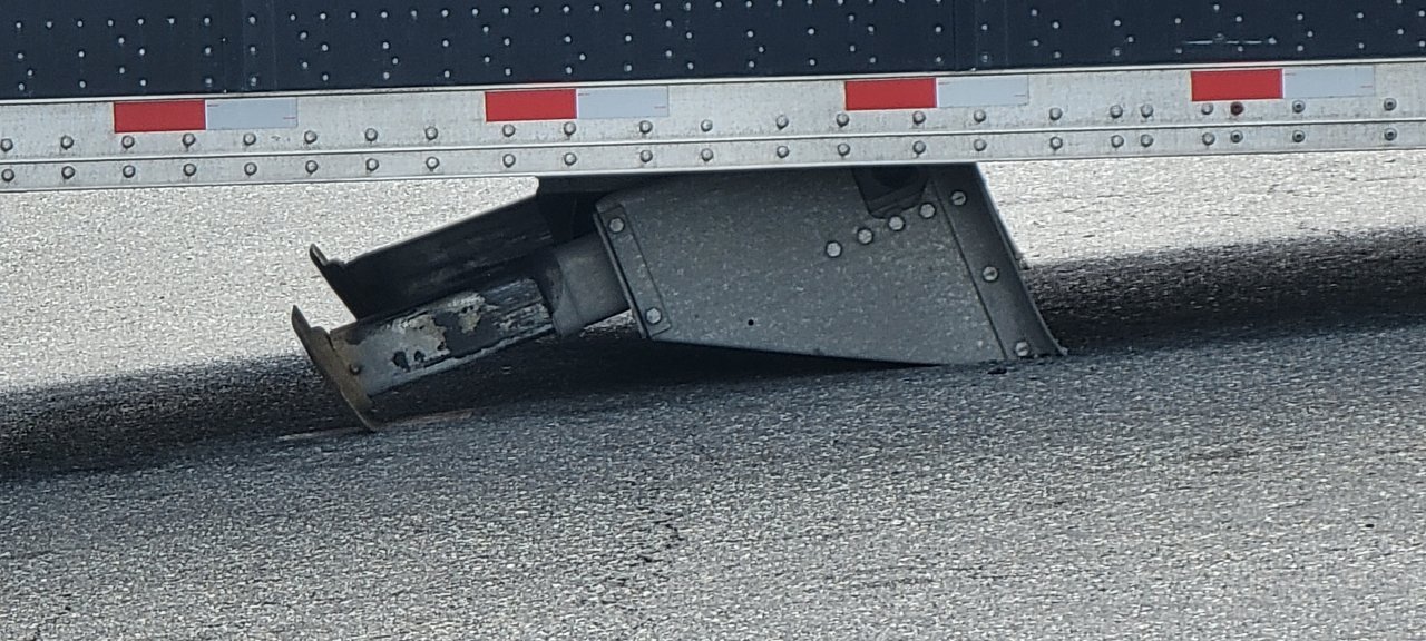

This is why you always tug test with pictures.

    Yea that could have been prevented with a few extra seconds, instead of being lazy.
    Ya gotta love these guys too that think they need to be going 15 mph in reverse when they hook up, and slam the living sh it out the kingpin like they’re joining couplers on a freight train….
  5. OLDSKOOLERnWV
    18,882
    284,558
    When I unhook I run the dolly legs down to the ground or close to it, and then dump the airbags when unhooking, and when hooking too.
    When I pull a strange trailer I always get close then jump out to see how the 5th wheel is aligning with the trailer. I usually set a little higher with 24.5 rubber than trucks with 22.5. I have to watch that closely when I pull my buddy’s van trailer.
    Some of his drivers only get the dolly legs close to the ground then pull out from under the trailer, so my airbag dump comes in handy there, since his trucks have 22.5 tires…..

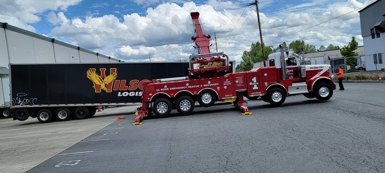

    Whew a 5 axle rotater boom wrecker, man I bet that was a fat bill to get that trailer up!!!
