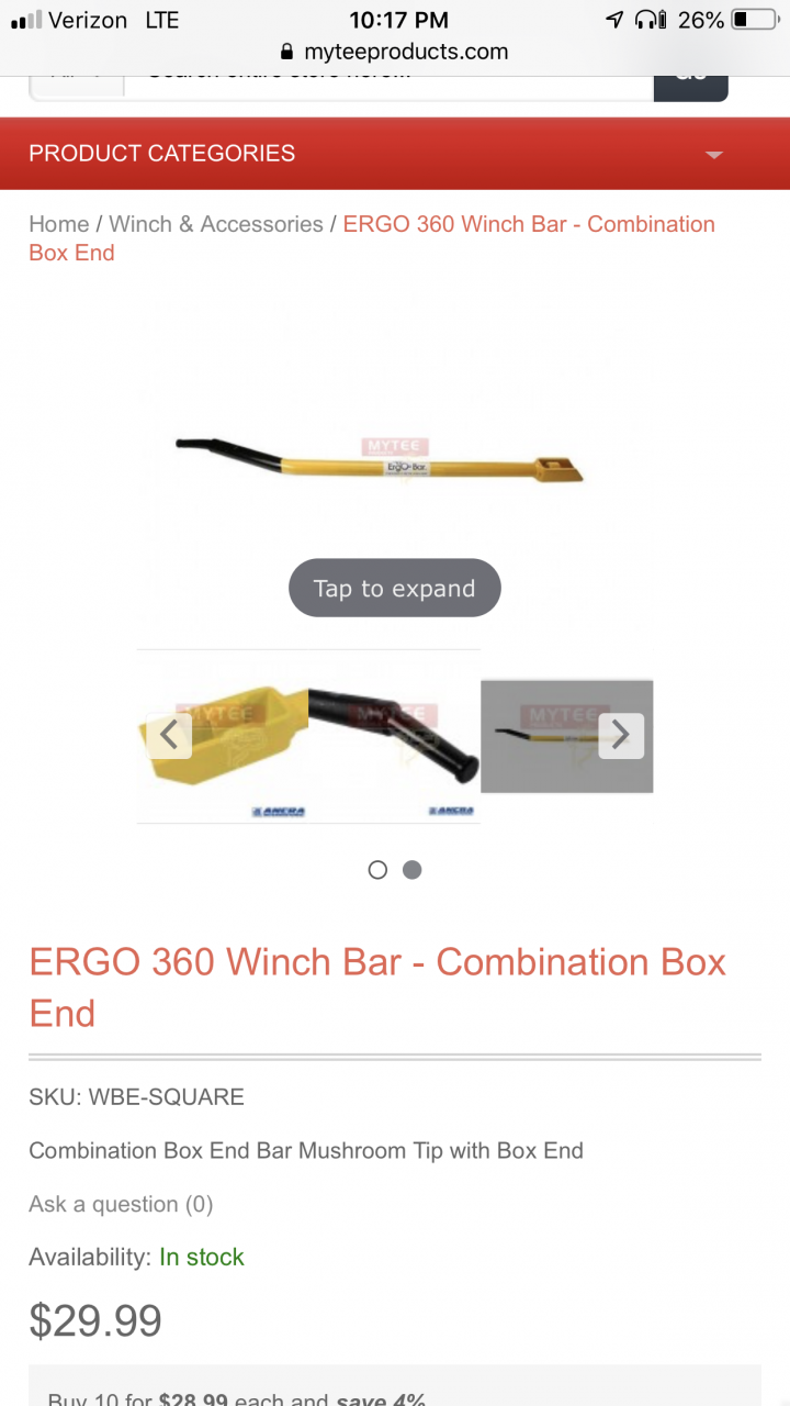

    If you’re a lightweight - I’d consider taking your winch bar to a machine shop and cutting and lengthening it. Just enough to get extra leverage.
    I use an ergo bar, rather than the traditional.
    All else fails - cut the strap with a razor.

    I just did a little reading about the ergo bar. Looks really nice. What does using the ergo bar enable you to do differently than a traditional winch bar? Do you think I could use a cheater bar with the ergo bar? The equipment is company owned but if I have to cut a strap to get the job done, I guess I'll cut it. I had not thought of that. Thank you.
