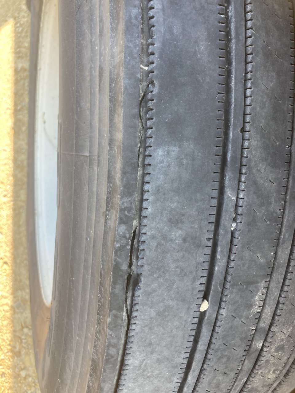

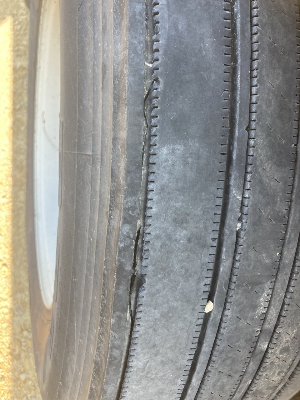

    We are at our company yard and Saw this on the trailer tandems during the pre-trip. Sent these photos and video to the owner son in charge of maintenance and he is calling the on call Mechanic to come change the tire.
    I’m new so I have no idea what is a big deal and what isn’t. Should I have bothered with this or is it worth having it changed out?

    Great job! That can be the start of a tread separating, which will tear the crap out of the equipment. Also, if it comes off and causes damage to someone’s vehicle, the company would be liable. And, that can possibly roll downhill to you. Again, great job!

    It’s cheaper to replace that tire at the yard than it is on the road, and a questionable tire should be replaced…. Our mechanics call them maypops for a reason.

    Middle of summer I would’ve wanted it off my trailer for sure. Cooler temps and proper inflation I’d be a little more comfortable running it unless I knew the trailer wouldn’t be back around the yard for a while.

    Good job on doing a proper pre-trip inspection and spotting the tire issue. To me, that looks more like the tire was cut possibly by an impact with an object or curb or something. Either way it should be replaced. As stated before, tires replaced in the yard by the company are so much cheaper than a road service call and a call to the insurance company after it caused damage to another vehicle.
    Keep up the good work.

    the mechanic agreed that the tire needed replaced and didn’t seem out of sorts about being called in on Sunday.

    I have been reading your posts from the start . And I have to say if all new drivers did things like you and your wife. This industry would be a much better place. Your attention to detail is really great to see... a lot of drivers would've missed that. And you probably just saved yourself a blowout... the rule I always have , is if I'm second guessing something or wondering should I change this out, the answer is always on the safe side. I'm sure it's saved my ### more then once.

    Yea and kinda close to the sidewall too.
    Sucky sucky. Just like in middle school after you dump your ugly girlfriend, it's time to change that rubber.
