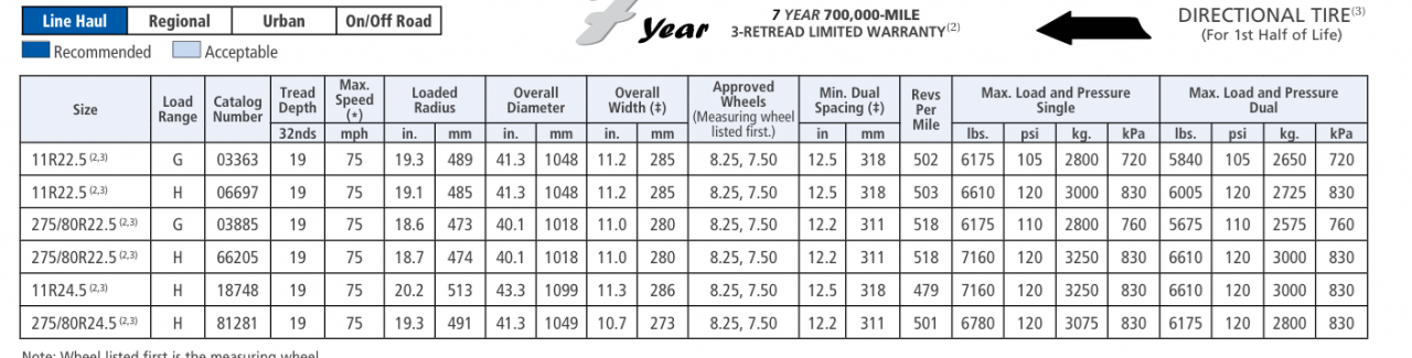

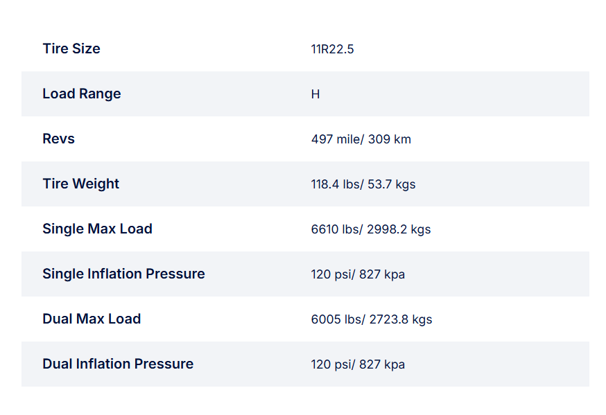

    Also two tires with the same sidewall numbers can have different RPM (rotation per mile) Cooper and Michelin tire for example 11r 22.5 H load 497rpm vs 503rpm.

    Both examples I listed are steer tires H load. The Michelin is 19/32, the Cooper is 18/32. 1.2% difference in rotation per mile or 1200 miles in a 100k year.
