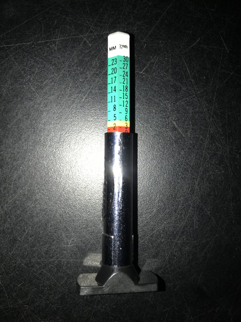

Tire tread gauge, how do you read it?

    OP do you realize they can't squeeze all those numbers into a 32nd of an inch so they put different numbers on different sides of the gauge? Just push the thing in till it hits and then take the gauge and spin it until you see a number that most closely matches where it stopped.

    Yeah bro - as said above - just read around the gauge and split the difference. 32nds are too close to jam together on one side.
    Make sure to check the very lowest point in a tire, that’s the way DOT will do you.

    Those tire gauges have two types of measurements: inches and millimeters. We only use inches, the sides with 32nds on the top.
    Generally,
    4/32nds (of an inch) is the lowest allowed on steers.
    2/32nds is the lowest allowed for the rest of the tires (truck drives and trailer tandem).
    Another way of understanding these numbers is by dividing it to find the percentage of one inch. For example,
    2/32 = 0.0625 = 6.25% of one inch
    4/32 = 0.125 = 12.5% of one inch
    16/32 = 0.50 = 50% of one inch
    32/32 = 1.0 = 100% of one inch = one inch
