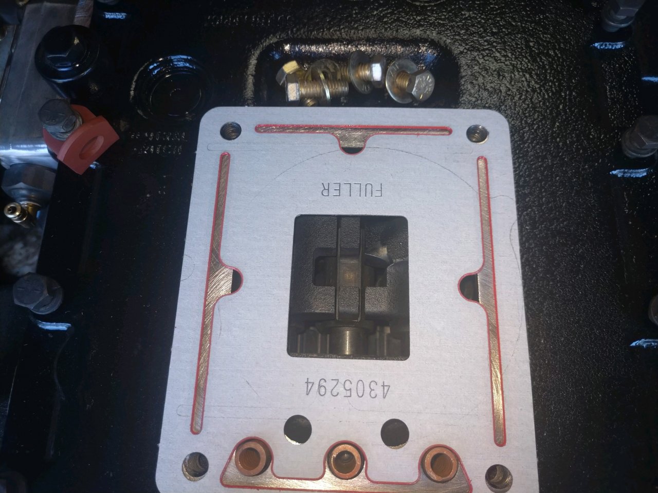

    Reviving this old thread, I have a 2014 with a 13 spd. I’m having a similar issue with the oil leak on top of the transmission(gear oil), seems it coming from the breather. When I was wiping the excess gear oil to find where it is leaking, I noticed an o-ring came out as I remove the shop towels. The o-ring was brittle. The breather looks like a “top hat”, would the o-ring came from the breather ? The shift tower is bolts are tight. And if it was the gasket from the shift tower, the leak wouldn’t be so excess. I cleaned it once and when I checked it again after about 100 mile, it was all over the top again. Can it be the breather missing the o-ring ?

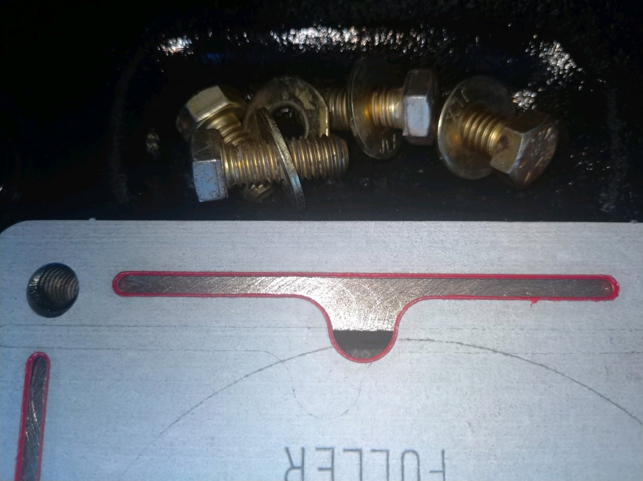

    10EEB4D6-E4E1-4C17-80C9-AF5DB6F2461B.jpeg 8E927B53-67C1-4DFF-840E-4660A58CA572.jpeg
    I’m in the process of having the shifter tower gasket replaced. My drivetrain specialist mentioned that the updated series of gaskets that have been out for awhile are common to leak in the front.
