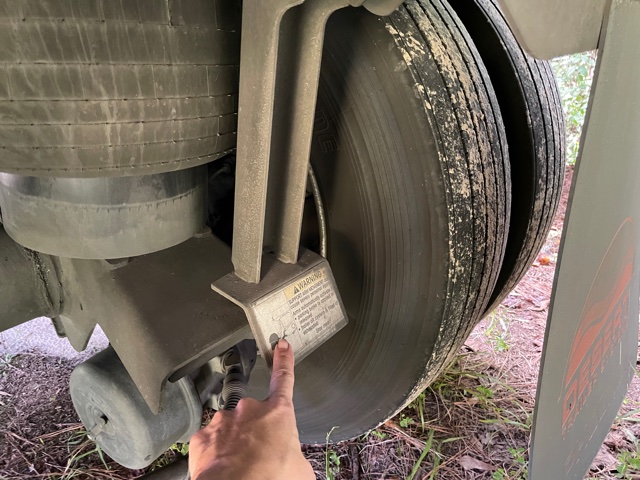

    Is there a bar on the rear axle like the one in this picture? If so, is it retracted with the trailer brakes released?
    Or is it sitting on the pad and the front air bags are deflated?

  8. Kolorado
    Kolorado Medium Load Member
    499
    723
    Feb 28, 2015
    Colorado/Texas

    Front air bags do seem deflated with trailer breaks not set
