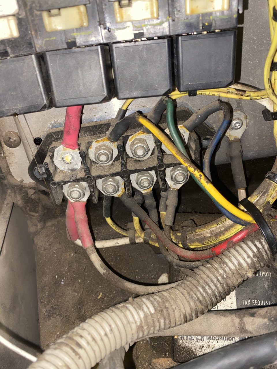

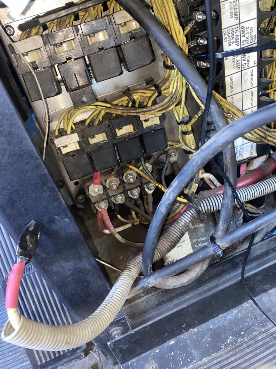

  9. Angelt6284
    Angelt6284 Bobtail Member
    6
    3
    May 17, 2022
    I got the above pictures looking at the trucks relays and stuff and a bolt was broken securing a line coming from the batteries. Could that be it? And what’s the pats name that holds all those cables together?

  10. blairandgretchen
    13,361
    71,776
    Dec 9, 2011
    South west Missouri
    Go to your FL dealership with the VIN and that picture, I’m guessing you’ll need that whole block, unless those bolts are replaceable from the rear side.
  11. Angelt6284
    6
    3
    May 17, 2022
    Yea I’m trying to get home this weekend to fix this I’ll see if it’s the problem . Thank you guys.
