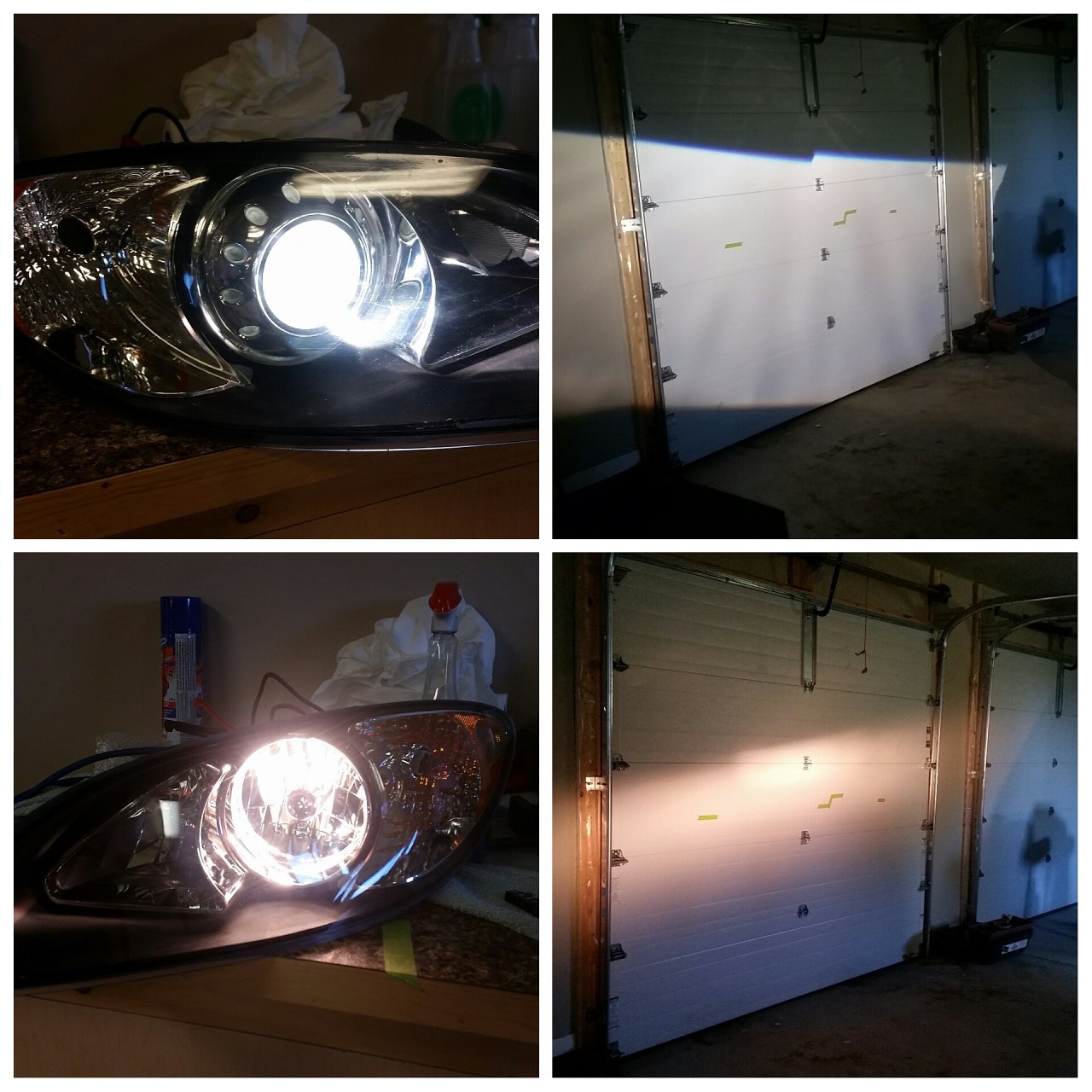

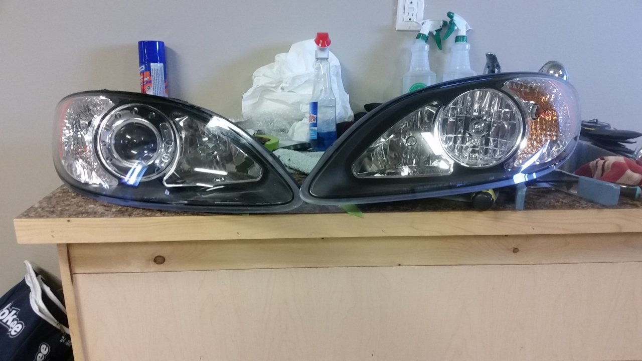

    Just spent the afternoon opening up the headlights on my 08 Prostar and adding in a bi-xenon projector. What a world of difference plus I get the brightness of hid without blinding oncoming traffic.

    Alot of deer and moose up where I run and I'm maxed out on my steer's and don't want to run a wider tire to fit a bambi basher so I figured the next best thing is to be able to see the buggers coming.

    I can tell that your the cranky type who hates hid lighting and probably rightfully so with most kids and people who don't care just adding a plug and play hid kit into their reflector housing.
    This is not that, if you look at the light output you will see a very sharp cutoff line, no light goes above that point and therefore does not blind oncoming traffic. Same type of projectors found in luxury suvs.
    I have done the exact same thing to my peterbilt and when I meet my driver on the highway, most stock halogens are bighter to my eye than him coming at me..... now if he flicks the high beam that another story!
