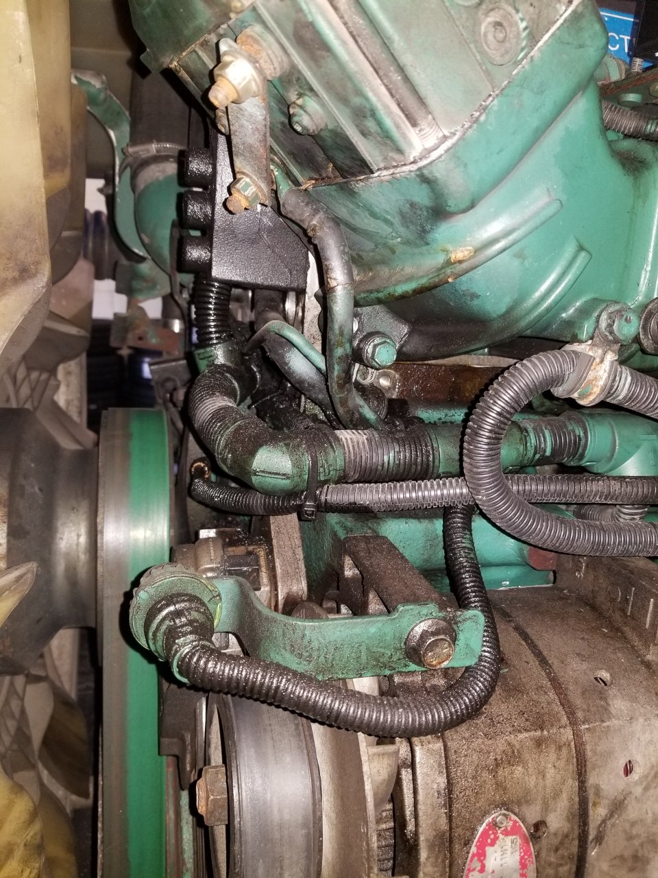

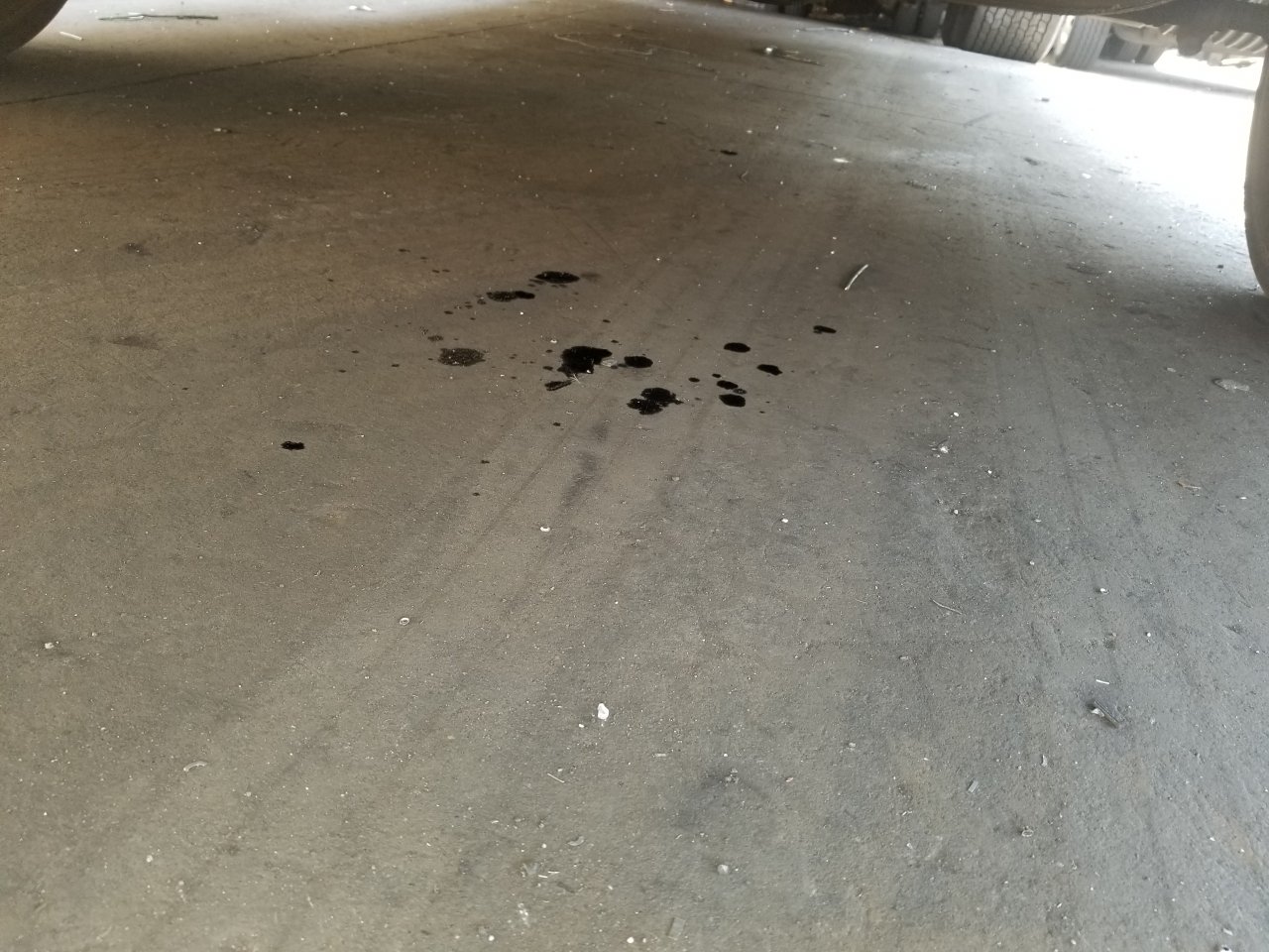

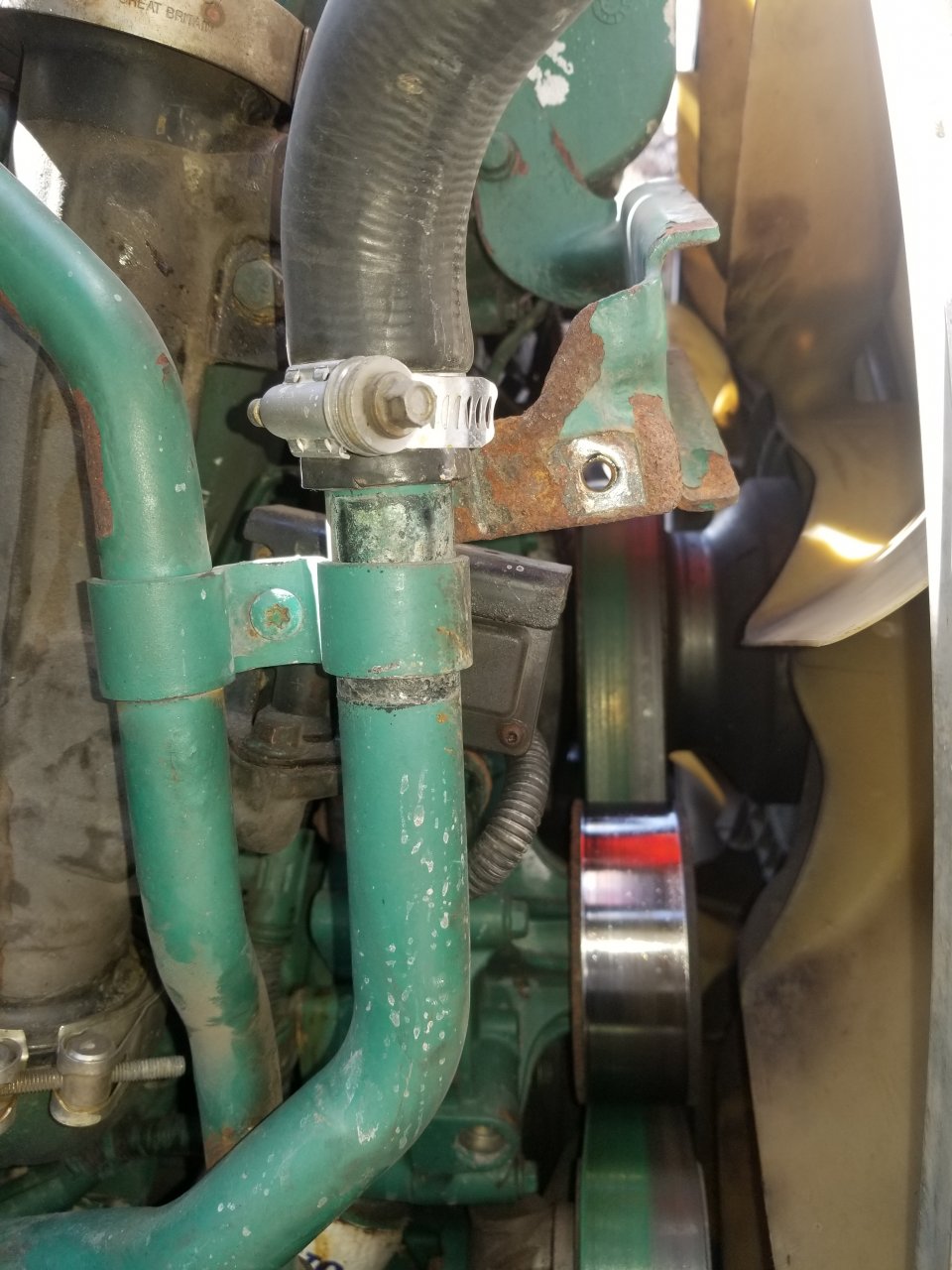

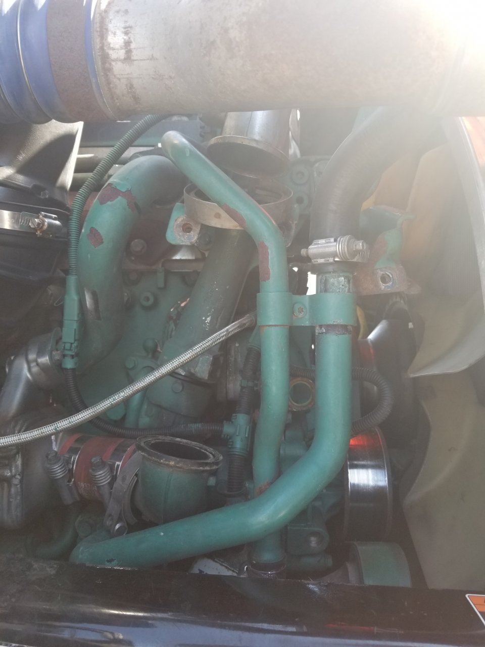

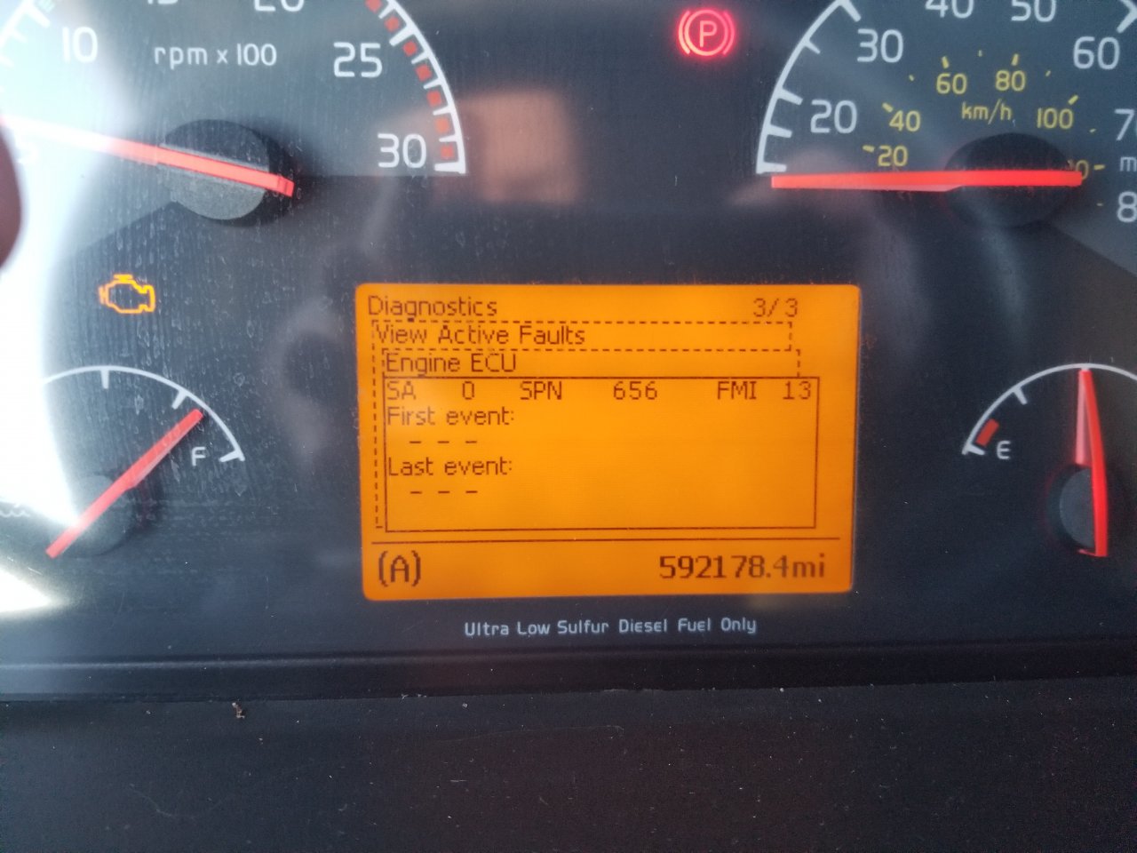

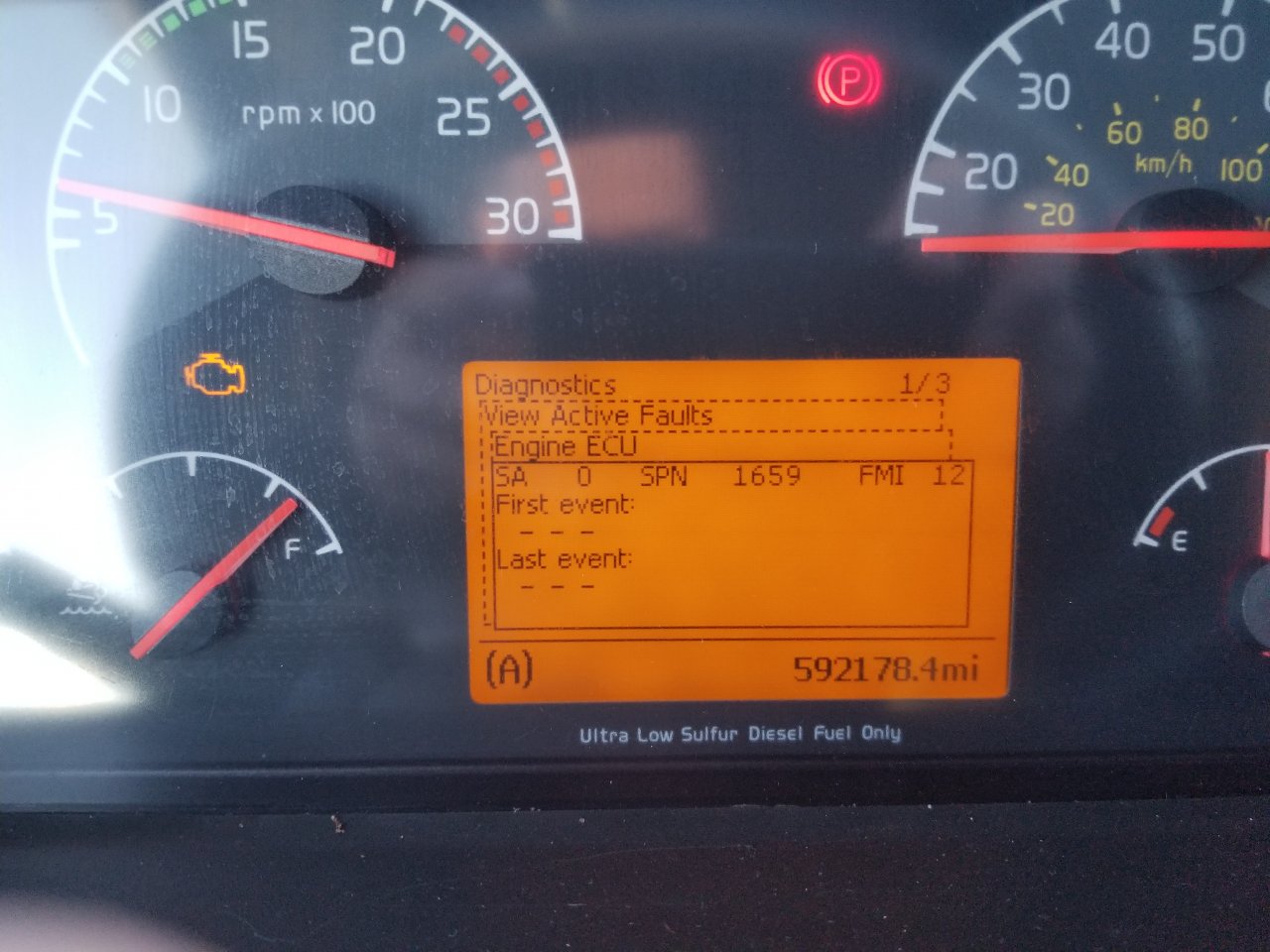

    I just want to close this post with some more info. Overhauling is done, and I am not so happy how this job was done because when i came to pick up the truck I had check engine light for coolant level sensor, they fix it right away, after 8 miles driving to Pilot i got 3 more codes(1 DEF doser valve SPN 5394 FMI 17, and 2 codes for EGR SPN 2659 FMI 18 and SPN 411 FMI 5 ) and I noticed a oil leak under, coming from front side of engine and broken grill. I was guessing that connectors were dirty and I used brake cleaner and compressed air to clean egr elec.connector and problem was fixed. And I took that cleaner for DEF doser valve and cleaned that as well and that code disappeared after some driving. And then i pay attention for work done and I was pissed off, I could lost my bumper and who knows what, I needed whole day to tighten all things that were loosen. Also I needed to change my transmission fluid again because Truck Enterprises Hagerstown didn't change it. I don't believe that this things can happen with Volvo dealership( law suit coming). This is the cost and some pics of job done....

    Some of the pictures of job done... 20190327_130503.jpg 20190328_133030.jpg 20190328_133122.jpg 20190328_133235.jpg 20190328_133607.jpg 20190328_144217.jpg 20190328_150345.jpg 20190328_171456.jpg 20190328_172225.jpg 20190328_172315.jpg

    SPN 2659 FMI 18 and SPN 411 FMI 5 SPN 5394 FMI 17

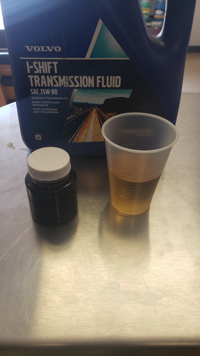

    That codes for EGR went back EGR SPN 2659 FMI 18 and SPN 411 FMI 5. I took venturi pipe out and found that one hole was clogged for EGR differential pressure sensor, used zip tie to come thru and cable to clean it with brake cleaner. No more codes and now I got better fuel economy but still its not near of that I had when I bought truck and heres why. I stopped at shop where they do overhauling and this is what they found in attachment. Its all caused of that diesel in exhaust system and clogging up all of components(EGR DPF). Also I took another sample of my transmission oil for testing and this is how it looks after almoust 5000 miles. Waiting for results...
