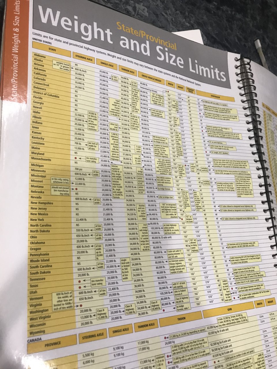

  5. blairandgretchen
    13,372
    71,835
    Dec 9, 2011
    South west Missouri
    A14 and A16 of your Road Atlas contain the legality of your situation.
    E00B5C14-8792-4D1B-9FE8-978303403FD5.jpeg F4A60261-B218-4637-9661-D5E06BD19216.jpeg

    Indiana goes off the axle/tire rating for your steers. Most states do. But not all. That's the atlas page in the previous post.
