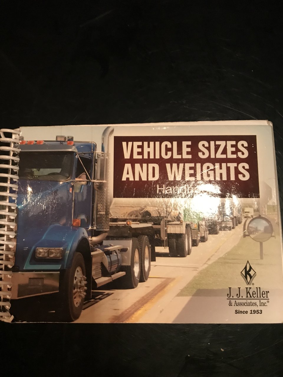

  8. truckdriver31
    7,001
    8,367
    Sep 18, 2013
    9EDAFB0B-6B61-444E-BE1F-17392FA33637.jpeg 9EDAFB0B-6B61-444E-BE1F-17392FA33637.jpeg
