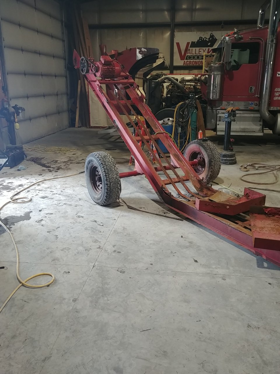

    What is that machine used for ?

    Its a belt conveyor. A wide belt runs around rollers from one end to the other, Right now all the rollers and belt are out of it. The lower portion can be slid under a hopper or trailer, then the wide belt carries the product out from under the hopper and up into something else. This particular one was built very specifically for feeding dry fertilizer into the elevator of our melt plant where we make our own liquid fertilizer. The enviroment around the melt plant is very humid, dusty, and corrosive so I built it out of very heavy steel to ensure that it would last a lifetime... But due to the enviroment it tends to eat bearings in about 2 years, they get heavily rusted and often will lock up and quit spinning.

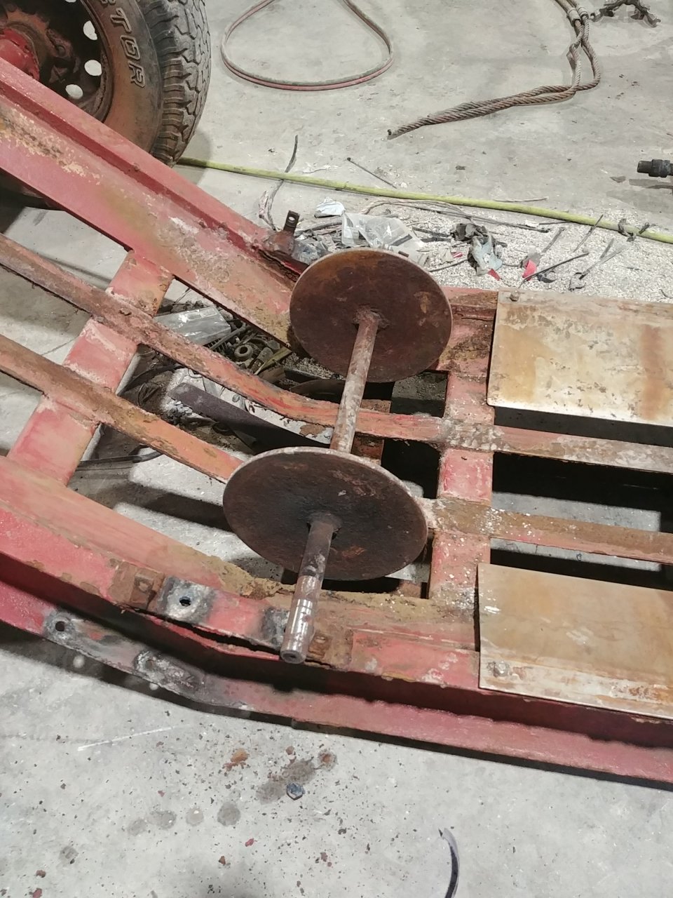

    How did you make the bend up? 2 belts or some middle idler nor shown now. In hindsight... Shoulda used 5 more gallons of Rust Oleum:D:D

    This roller rides on top the belt at the bend, but still allows product to ride the belt.
