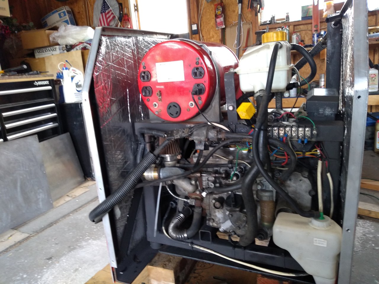

    Here what my generator is.
    Total price about 2000 or less.Need to look invoices.
    Engine is most expensive part. Scored it from Ebay for 1200.00
    Generator head from local sale for 250.00.
    Controller from Amazon for 80.00
    Coolant pump from Amazon 20.00
    The rest is from auto scrap yards.
