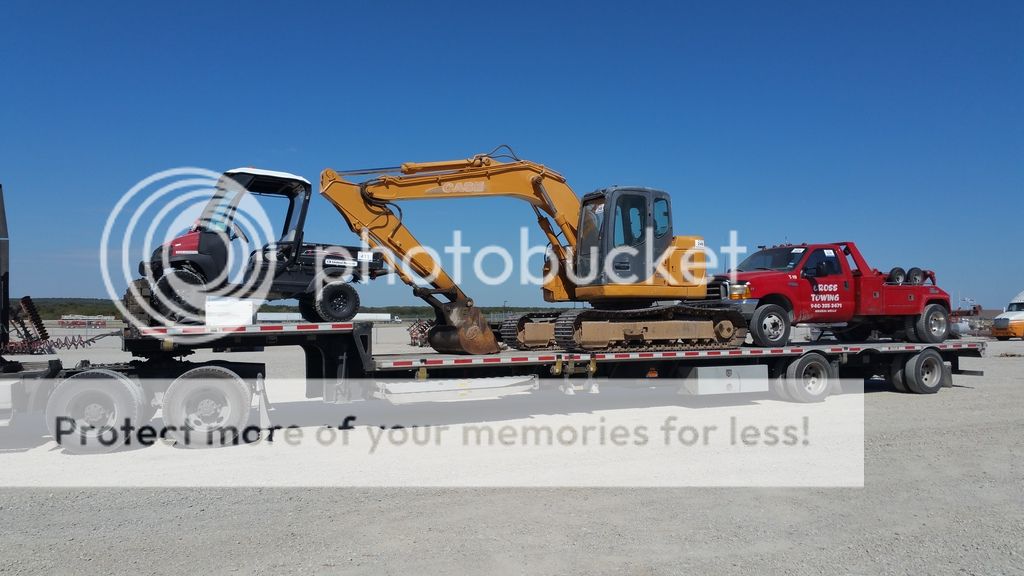

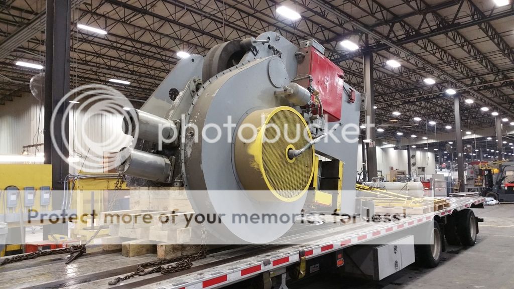

    The others will probably be bored of seeing these pics posted over and over,.. I dont think you have seen them,.. so I'll post what I do to give you an idea of the versatility of the step.

    [​IMG] [​IMG]
    All of these were brokered loads off the boards.
    Most of them paid pretty good,.. all things considered.
