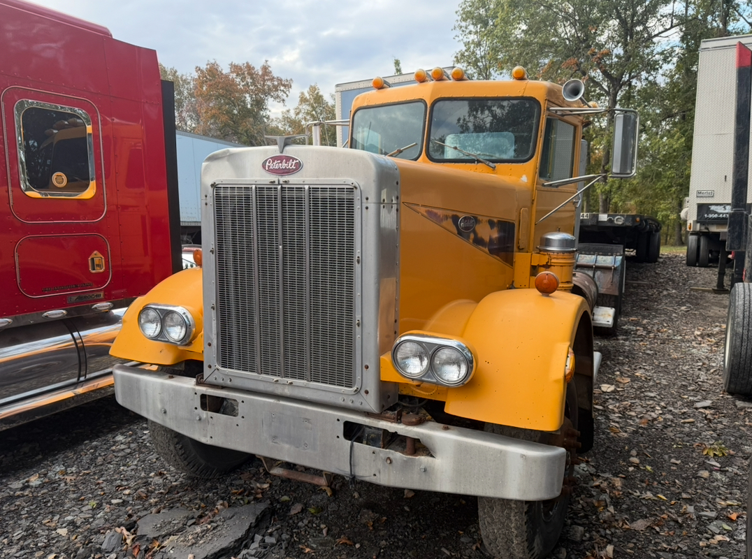

    Hello everyone!
    My name is Dennis and I am here in Germany - beeing infected by the V8 virus since 20 years now. The "biggest" truck I ever had so far was an 86 Chevrolet K30 M1008. This year I went to USA for an east coast trip and became more and more interested in the "big ones".
    Currently I am learning more and more about the models of Kenworth, Mack, Peterbilts and so on. Especially 60s to 90s.
    Now I wonder what this old Pete could be.
    It should be an ´67 288, but the hood and the front lights seem to be from another truck. There are a lot of things on it that doesn´t look like they belong to a 288 from 1967.
    Can anyone tell me whats going on here?
    Regards
    Dennis

    Welcome aboard. I think that's a 359 hood with 3 bar grille grafted onto a 288. I think you could get "double round" headlights into the 80s.

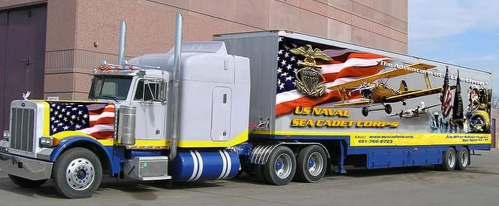

    I cannot answer your question. But here's my truck.
    1991 379 ext hood
    19,000lbs
    Twin 200 gallon tanks
    893ci turbo inline 6, 14.7 liters
    15 speed tranny
    Currently 2.4 million miles. In frame rebuild done at 75,000 miles under warranty. I believe I'm am the 4th or 5th owner.
    As I understand it's history, it was originally used to run produce from the east coast to the west coast; then it was used in a farm setting and ultimately ended up sitting untouched for years and years. It was then purchased and used to run OTR on short stints. Then my friend purchased and fixed it up and he started a business doing air shows in small planes. Which is why it looks like an aircraft carrier (CV-64). All that is paint, not a vehicle wrap. Then eventually he retired and drove it to Florida where he lives and I purchased it from him about 9 years ago. That's why the miles seems so low.

    @201: Thank you. thats why this truck confused me...

    That's more like a 288 I've seen. The thing was, as motors got bigger, cooling them was an issue, and the 359 came out in late '67, and had a wider front to accept a bigger radiator. Most older Petes had single headlights. This was my '72, and the last year for the smaller windshields. IMG_0171.JPG

    It’s a 289. That was the 2 axle 359. Peterbilt model numbers back then were different then today. 2 meant single drive 2 axle OR single drive 3 axle.
    3 always meant tandem drive 3 axle.
    281/351= narrow nose (standard width) butterfly hood.
    288/358= narrow nose tilt hood ( like in @oxbows pic)
    289/359= wide nose tilt hood.
    All the cabs were the same. They were available in both Aluminum and steel.
