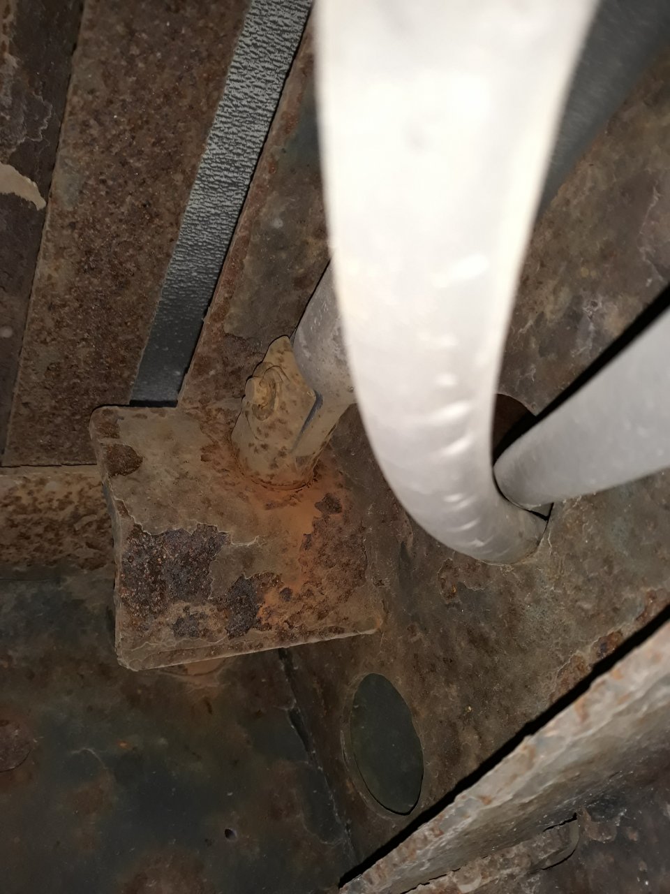

    That is the linkage for your pin. Air is used to retract that linkage and pull the pin in. It's not pulling a vaccum, it's simply using air to make the pin retract.
    If the parking brakes are released, air is immediately evacuated from the pin system, forcing the pins to relock.

    Are those two light-gray colored tubes the linkage for the pin?
    How does the air retract the linkage if not by a vacuum? Does air PUSH the linkage in (using positive air pressure)?

    Yes, the linkage is pushed in, just like on a mechanical mechanisim.
