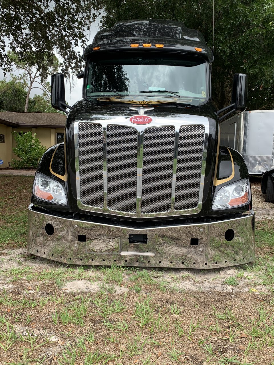

    Remove it
    It’s just a “ pretty my truck thing “ Peterbilt does
    I was having many issue and it was going off in the rain. Slamming the brakes etc
    I called the VP and he said try removing that cover
    I pulled over. Pulled it off and no issues
    That was about 150k miles ago

    Here’s mine
    Although I swapped the bumper. Still no issues

    The other truck brands don’t use the cover
    It’s a Peterbilt thing
    I think the distance between the radar and the cover is the issue
    If my radar ices up then the system will shut off meaning that the cruise and all that stops but it recognizes that there an obstruction which is what it’s supposed to do
