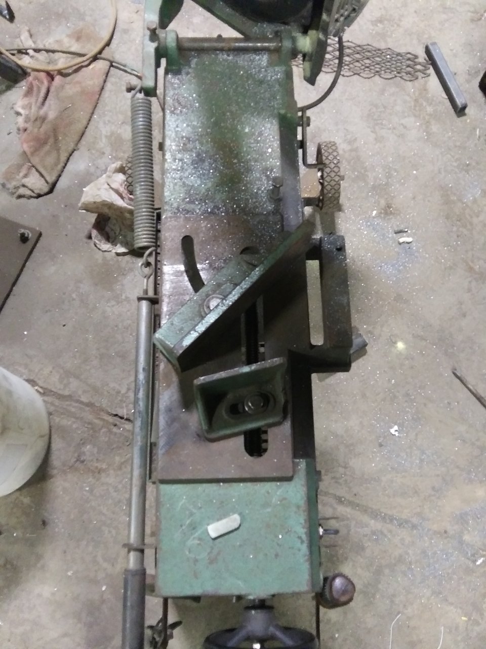

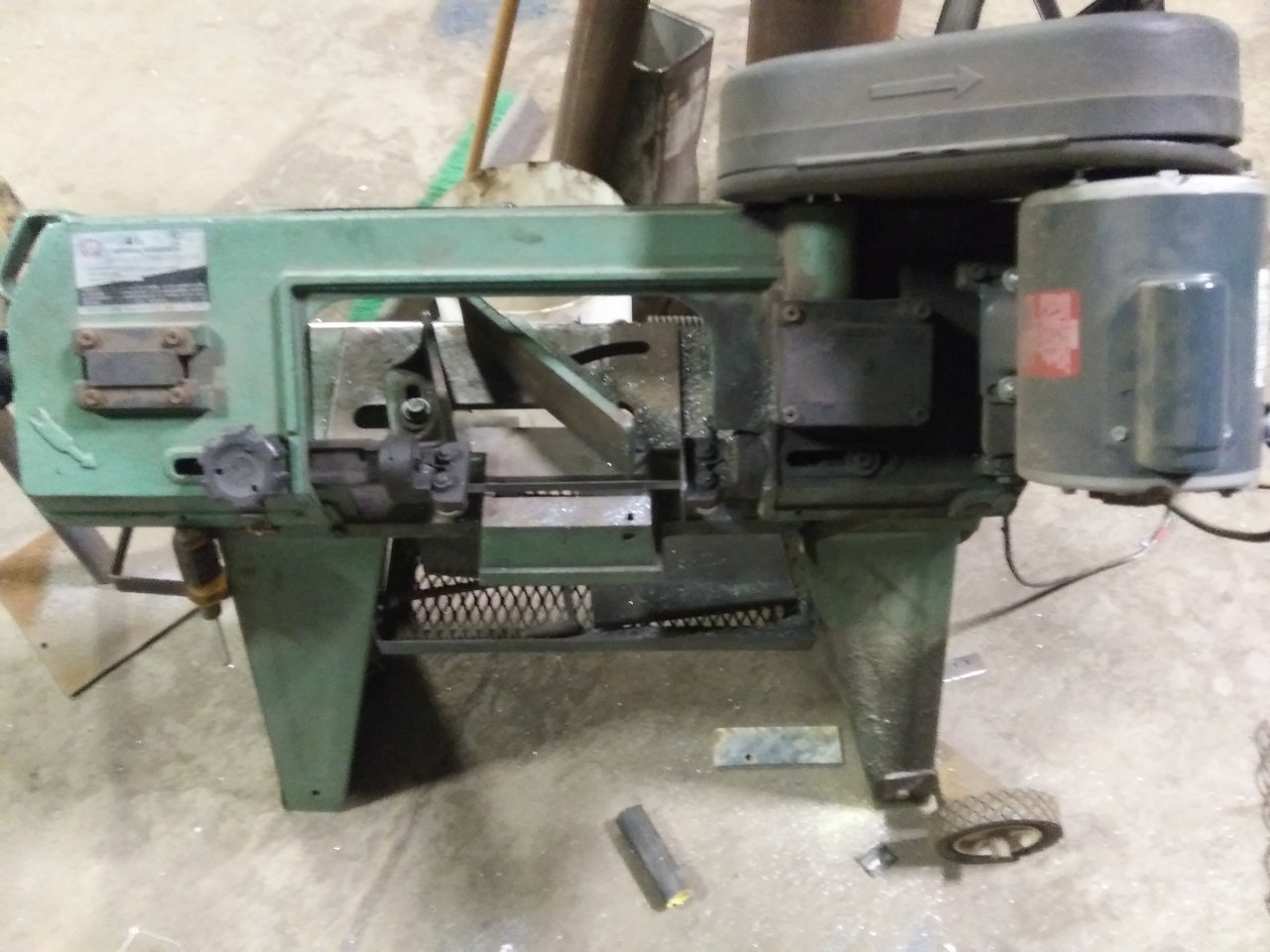

    Here's my 4" x 6" tractor supply special my FIL bought me in '04, and some of the modifications we did to it. I have cut stuff on here that was never meant to be cut on a saw this small. Take the sliding portion of the vise off and you just gained a little more capacity. You do have to get creative with the clamping when you do that.
    Also, buy the bi-mteal blades instead of the carbon steel blades. They last 3-4 times as long and most of the time, I've worn them out instead of breaking them. I have yet to wear out a carbon steel blade, they always break first.

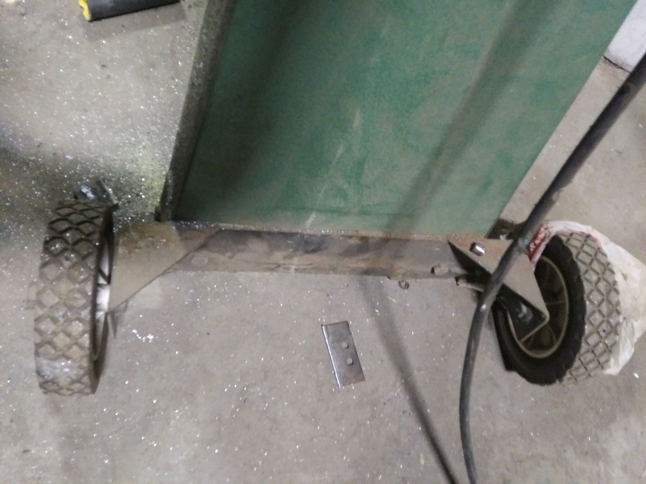

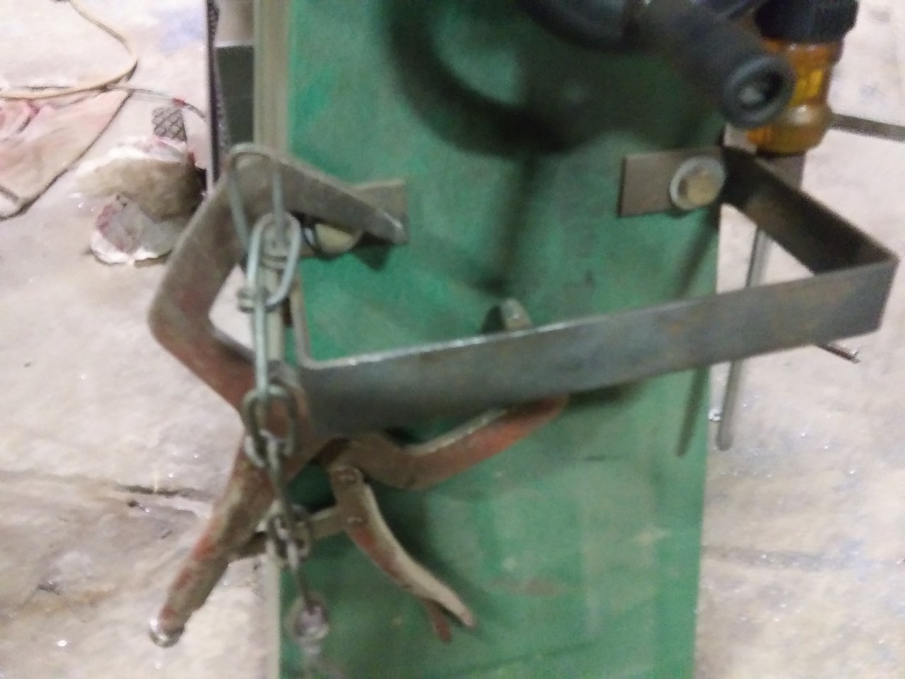

    A set of cheap wheels and a handle. The chain, which is a must, is to keep the top from flipping back when you roll it around. They're not heavy at all, but it beats picking it up or dragging it everytime you want to move it.

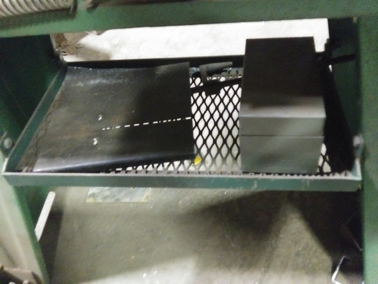

    The tray stiffens the legs up greatly as well as giving a place to store stuff. That is a metal recipe box that I keep extra roller guides as well as the safety stuff off the saw in. I also keep an allen wrench in there for adjusting the stop on the side and changing out the roller guides which are nothing more than sealed ball bearings. I forgot to take a picture of those, but they're easy to source.
    A large Phillips head screw driver is necessary for blade changes. The only things I have replaced on this saw are blades, the motor (this saw has been used hard) and 1 roller guide.
    If you look at sliding portion of the vise in the 2nd picture, you'll notice the corner nearest the blade is rounded off. It sticks out when making an angle cut. That is what got the roller guide.
    It really doesn't matter if you get the saw at Harbor Freight, or Tractor Supply or anywhere else like that, they're all pretty much identical just different colors.
