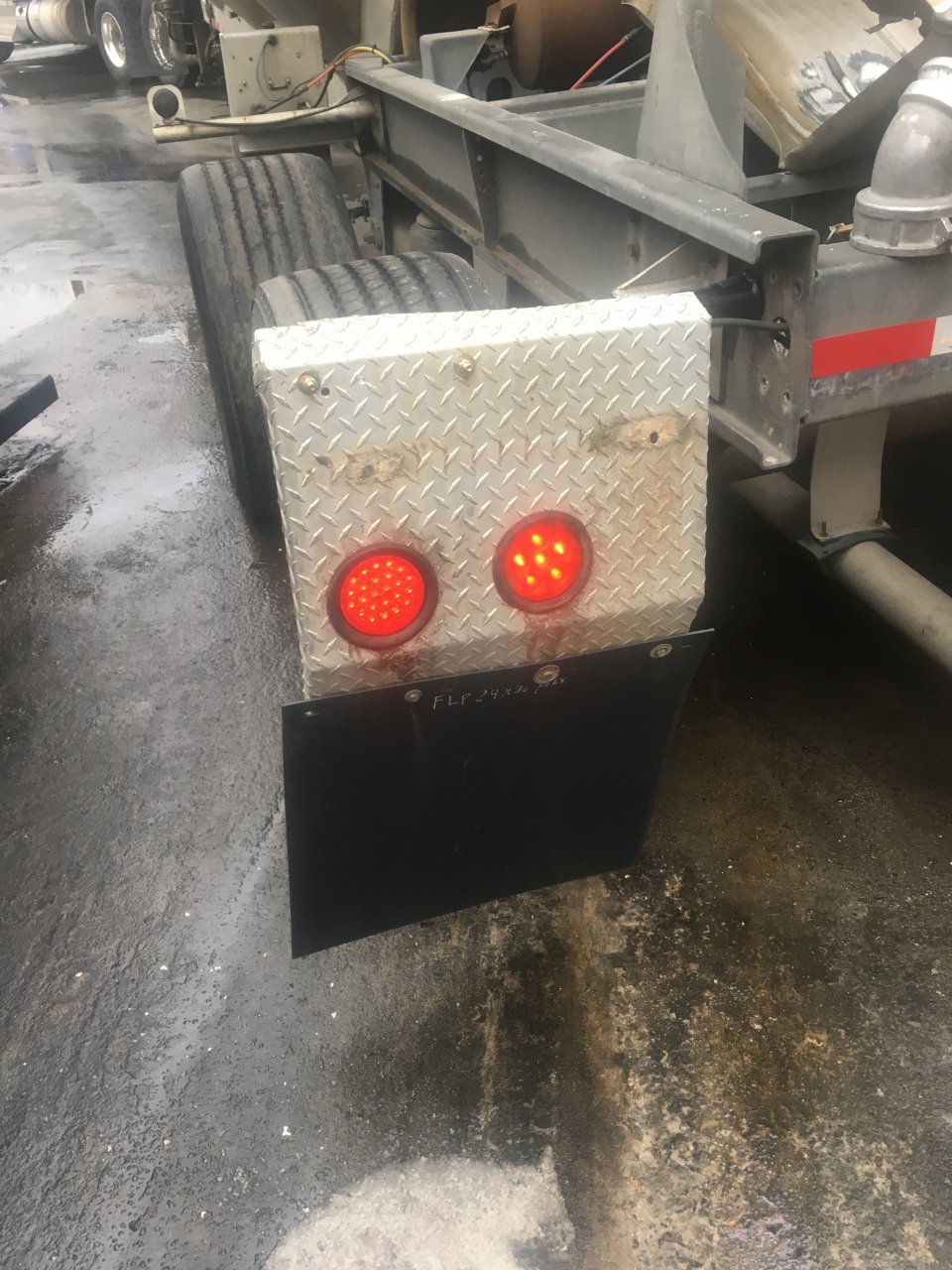

  5. LTL Bull
    LTL Bull Road Train Member
    1,561
    6,568
    Mar 12, 2020
    Rim was trashed. We own the shop. The owner operators run heavier sleeper cabs as we do overnights. Their company trucks are specd day cabs with super singles. They can take about 51,000 to 52,000 we don’t pull over 48,000. I know of at least 4 blowouts over the past 1/2 year I’ve been there

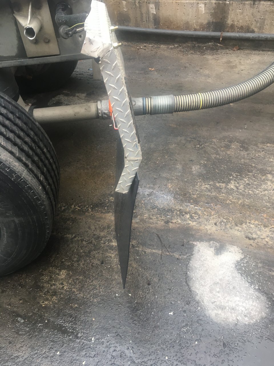

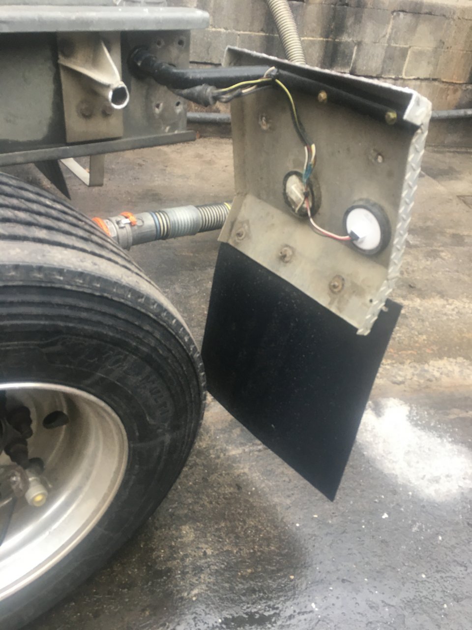

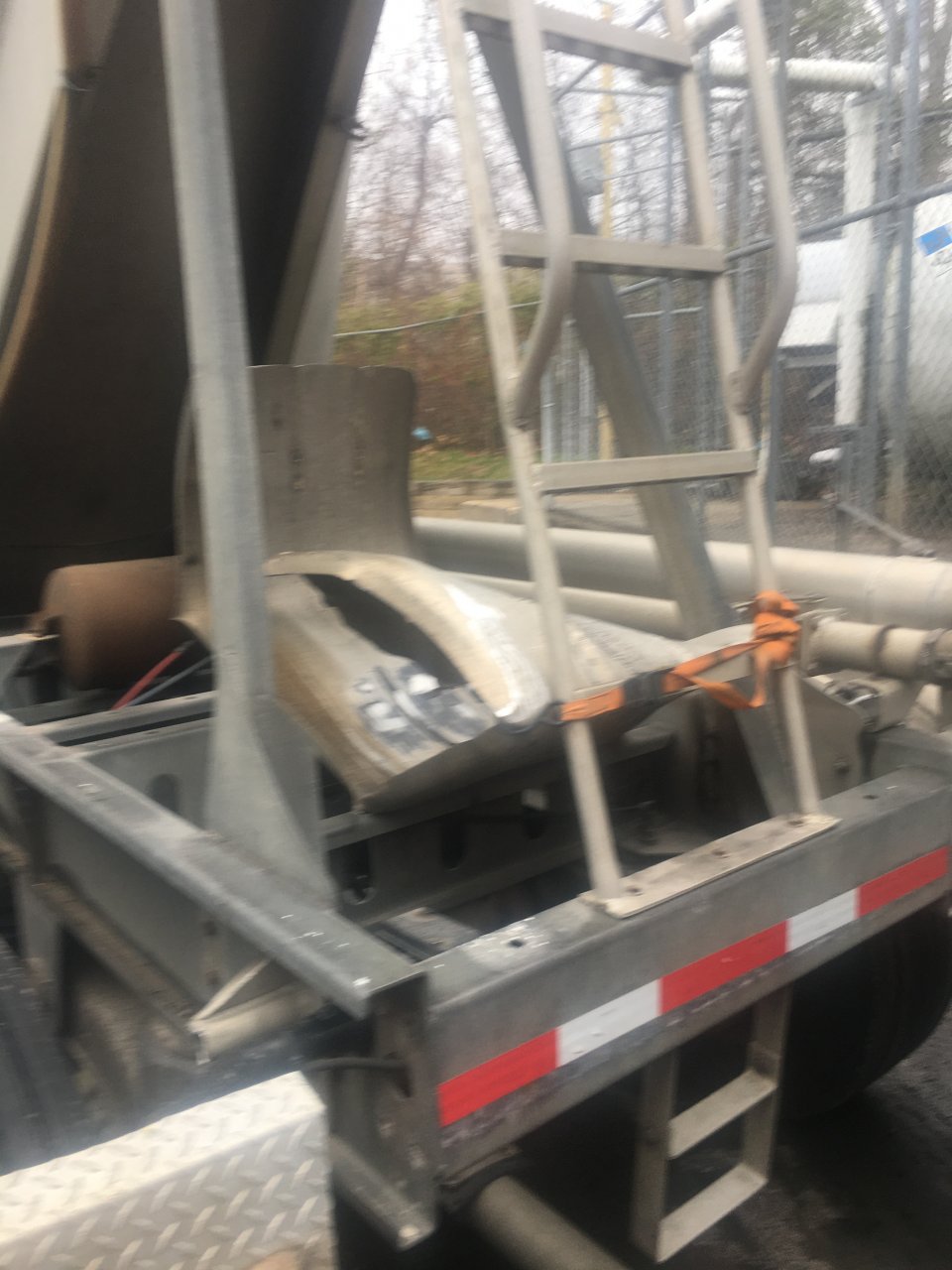

    The temporary repair to get me back to our shop and one of the KIA 55E62E5D-68AE-40ED-8D22-FB7036EF423D.jpeg 1B5DC7AA-AFD7-43FA-B45E-5AFE59CD884E.jpeg C3F6E98C-8708-4A8B-87B1-8B052940AD3E.jpeg D5B2726C-758F-46AB-9153-9C4423DBFCD2.jpeg
