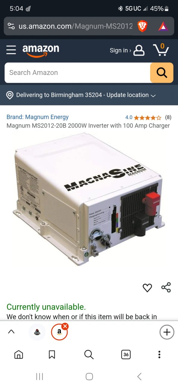

    I can tell you this from my experience, I have what I think is one of the best inverters you can buy the Magnum MS2012-20B pure sine wave, it's what Bolt sleepers puts in their big bunk sleepers, with brand new batteries/165 amp alternator and running down the road at 70mph, if my wife needs to run ours for any length of time she has to fire up the generator to keep it from dragging the batteries down to the point of ours throwing the low battery warning.
