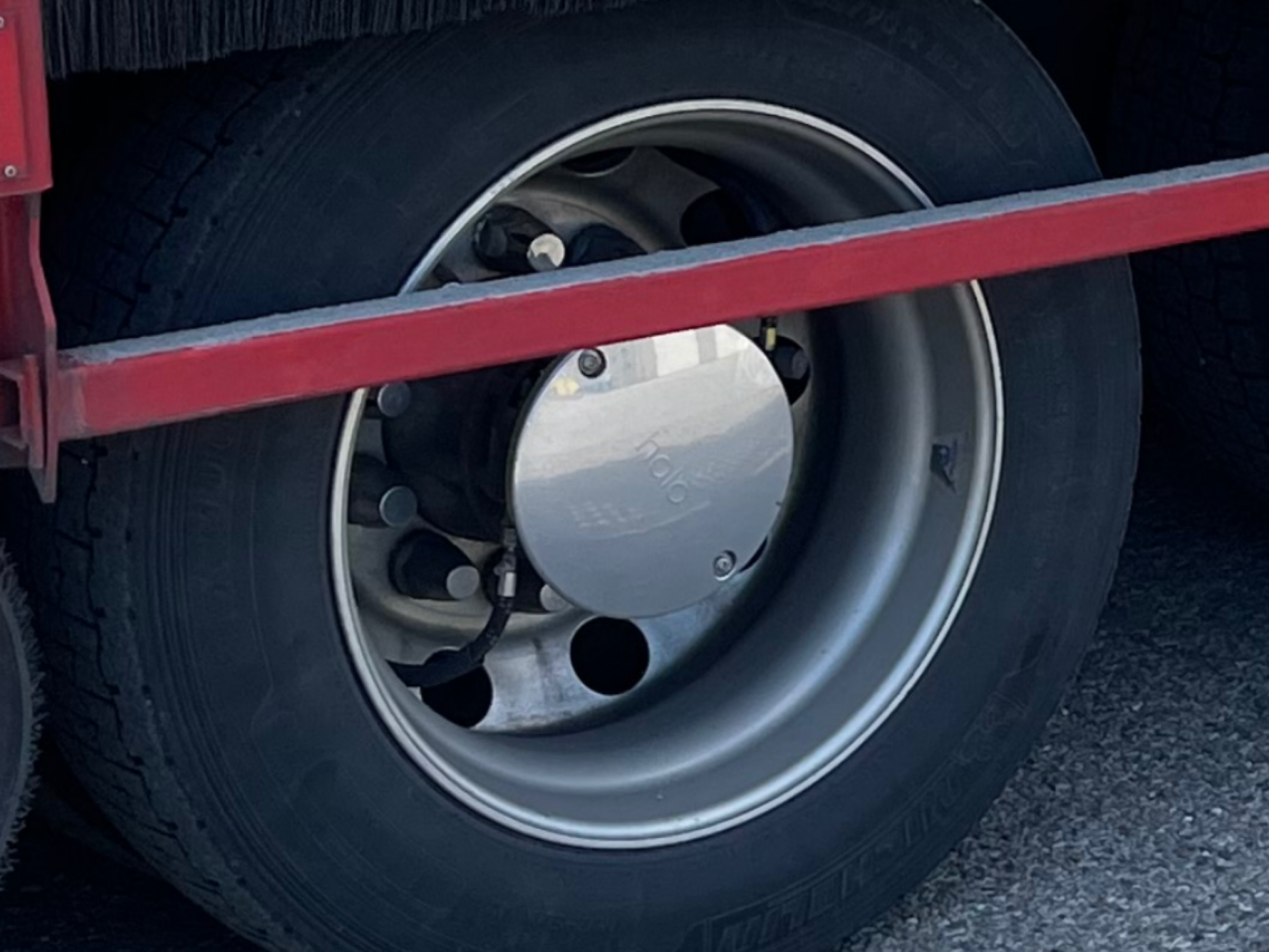

    I have used the halo system on my drives for almost 6 years and they are well worth the $1,400 they cost me. My trailer has the Hendrickson system and it cost roughly $1,200 and worth it also. FBC6F682-6AA3-4CD5-AA27-0B9A5223E7CD.png
