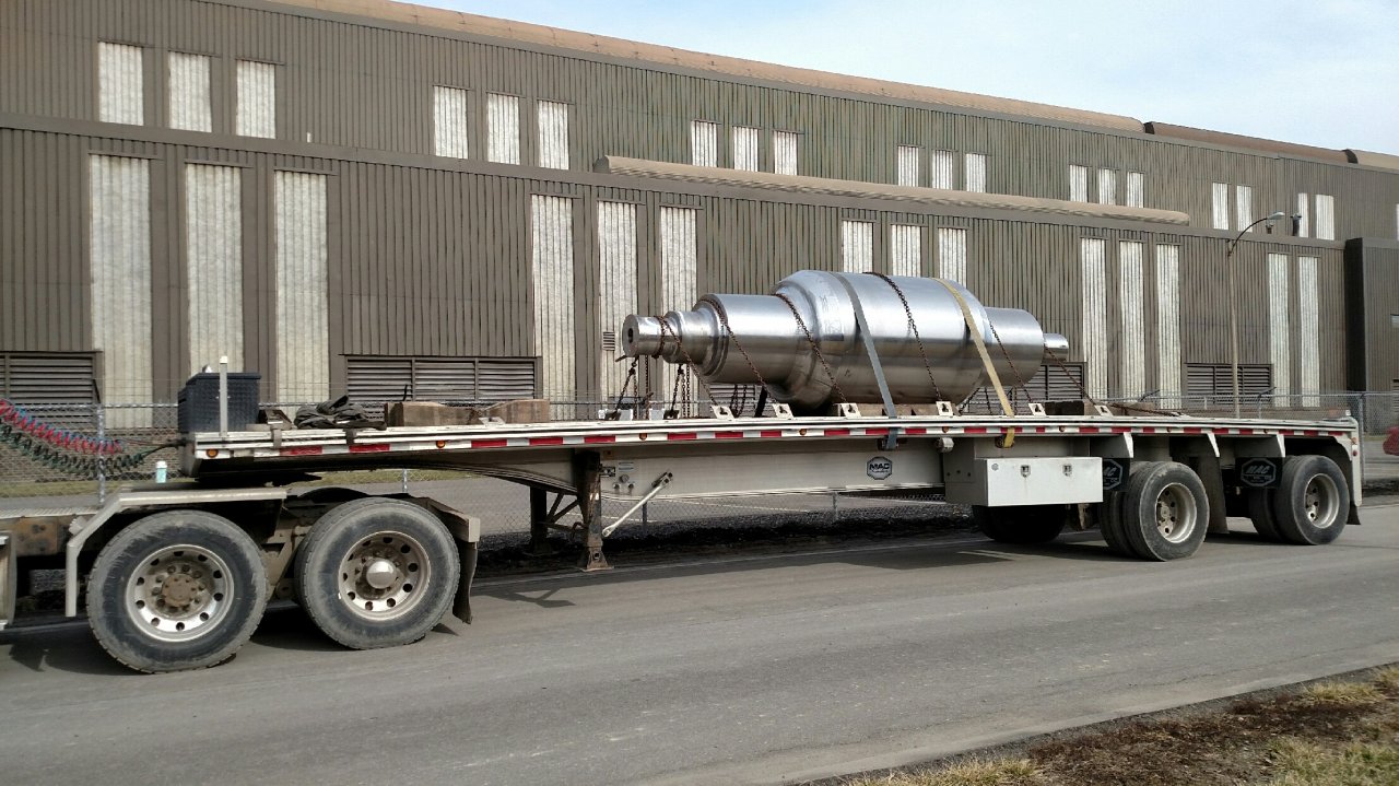

  9. DL550CAT
    DL550CAT Road Train Member
    1,427
    1,482
    Oct 18, 2009
    Waynesburg, Pa
    I think it's because of the way they attach the pockets.
    I will agree to disagree on Reitnouer being the best..... my vote goes to MAC. Over 80k in 5 feet with plenty of arch no Reitnouer would hold it as well. This trailer run for over 5 years every day. Not all were over weight but we did 5-10 permit loads (rolls weighing up to 86k) a week with it. Lots of twisting turning when loaded heavy. It never had a weld crack. Even after they dropped a 66k pound roll on it was not hurt too bad. IMG_0062.JPG
