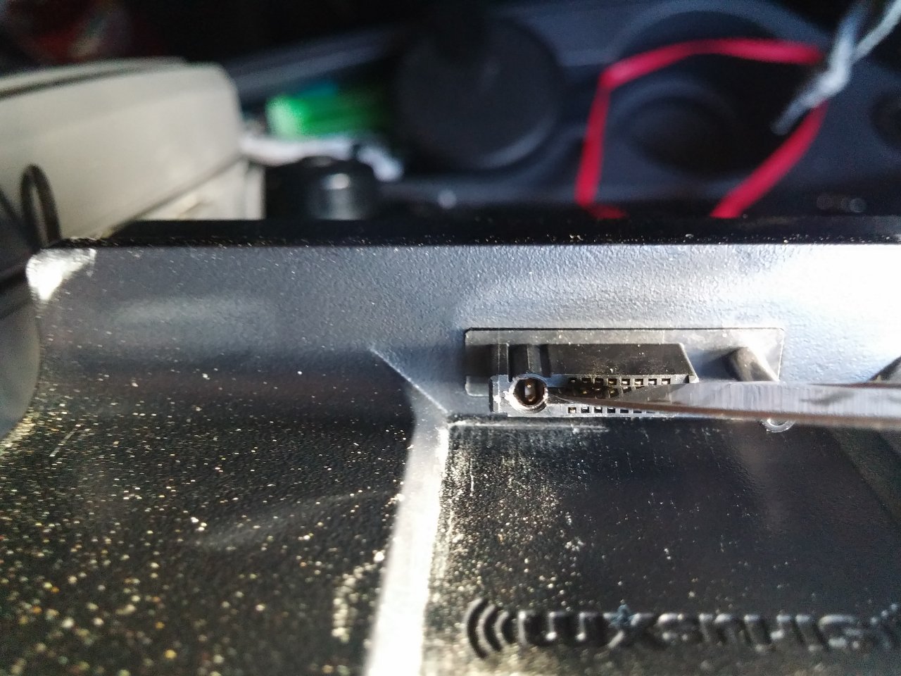

    Sorry for such a long wait but i needed to make sure i tested my theory b4 posting. Lets just say 2 radios later i believe i have found the inexpensive way to fix your onyx plus reception problems. Just for future post this is for when your radio says attenna disconnected or no attenna. Well the first radio i messed up trying to pull the prongs a little wider. Lets just say i kicked myself for that. But all you need to do is push in the attenna connection on cradle with a sturdy knife or flathead screw driver. Please see pic posted. DONT mess with radio unit it self. YOU WILL BE VERY MAD. Dont push with alot of force because you need connection to fit.if you still go down the road and it is still getting same message try pushing in a little more as needed. I have tested my theory for about 3 months now and i only lose signal when im not in sight of sats. I have hit 81,64,95,75,77,70,85,and many other roads good and bad and no. Attenna problems. Hope this helps.

    Please make sure to disconnect power and all aux cables before attempting. The circle on the left of picture is the attenna connection for radio. There is a gap between it and power connection strips to push in attenna connection. I have an air vent mount so it has been tested with extreme heat and cold air.

    I found the antenna plug fused to the cradle (Onyx Plus) so had to order a new cradle. New antenna is now fused to the new crdle but still get great reception. Well, now I do, what I had todo was use a large spring clip to squeeze the cradle and the radio together as the vibration of going down the road caused it to go in and out of signal.
