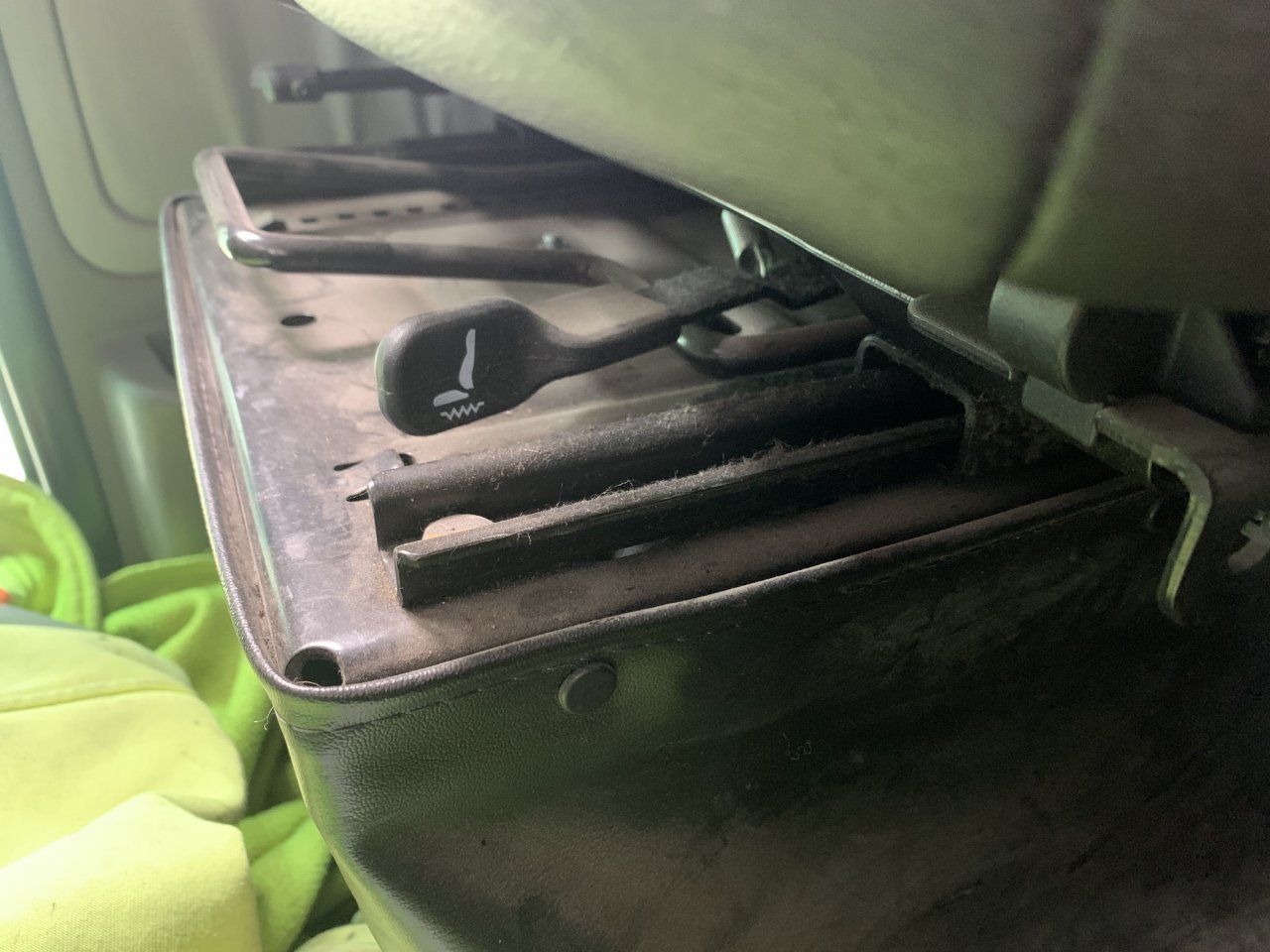

  7. Roberts450
    Roberts450 Road Train Member
    2,237
    3,634
    Feb 6, 2016
    Easiest to just start flipping the levers on the seat. That is if your seat has the isolation feature. This is what it looks like on my Sears Atlas II seat.
    sekhon617 Thanks this.

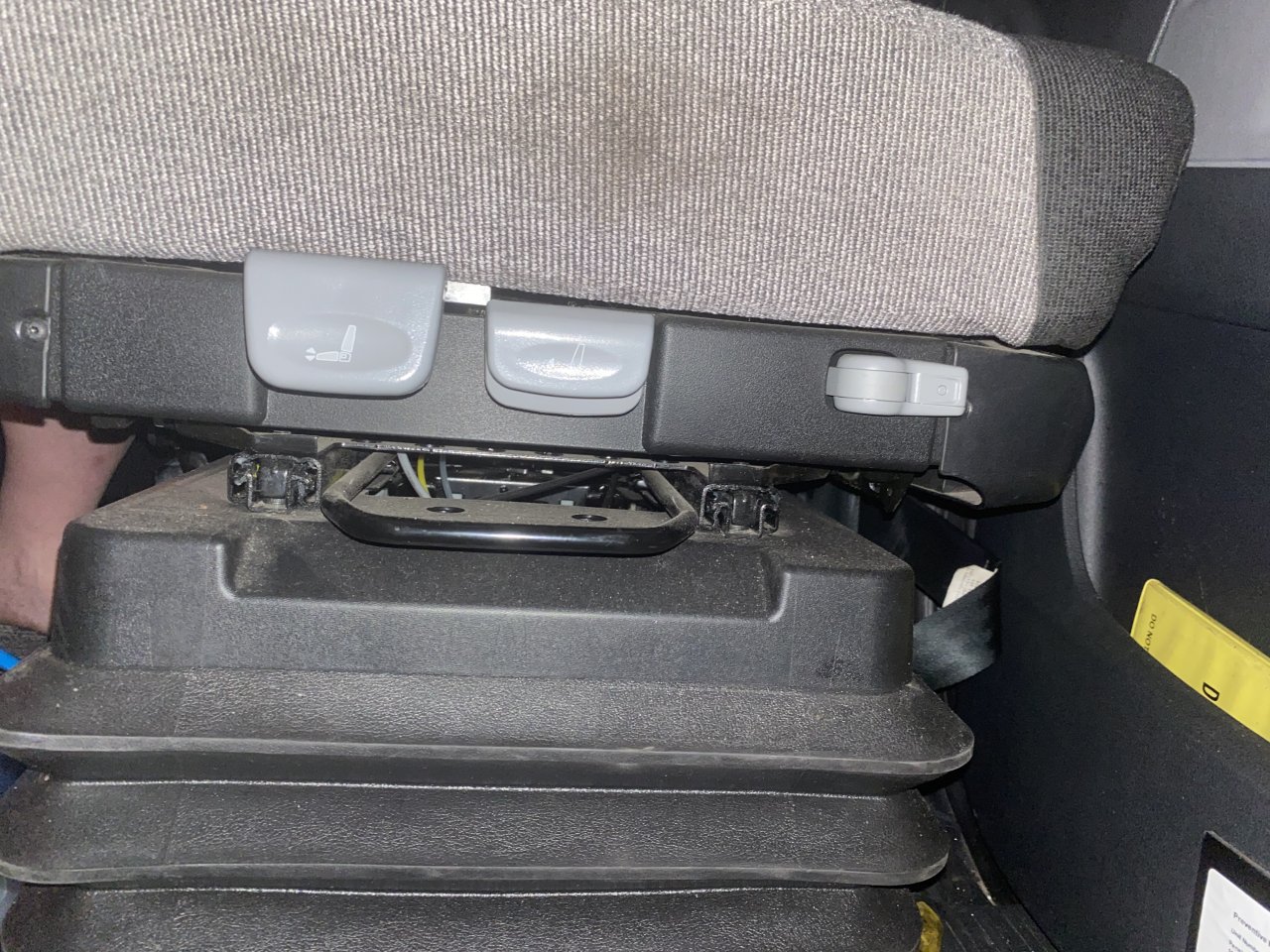

    On my Freightliner, the lever on the right side locks the seat from rocking. It’s on the left as you sit in the seat and reach down.

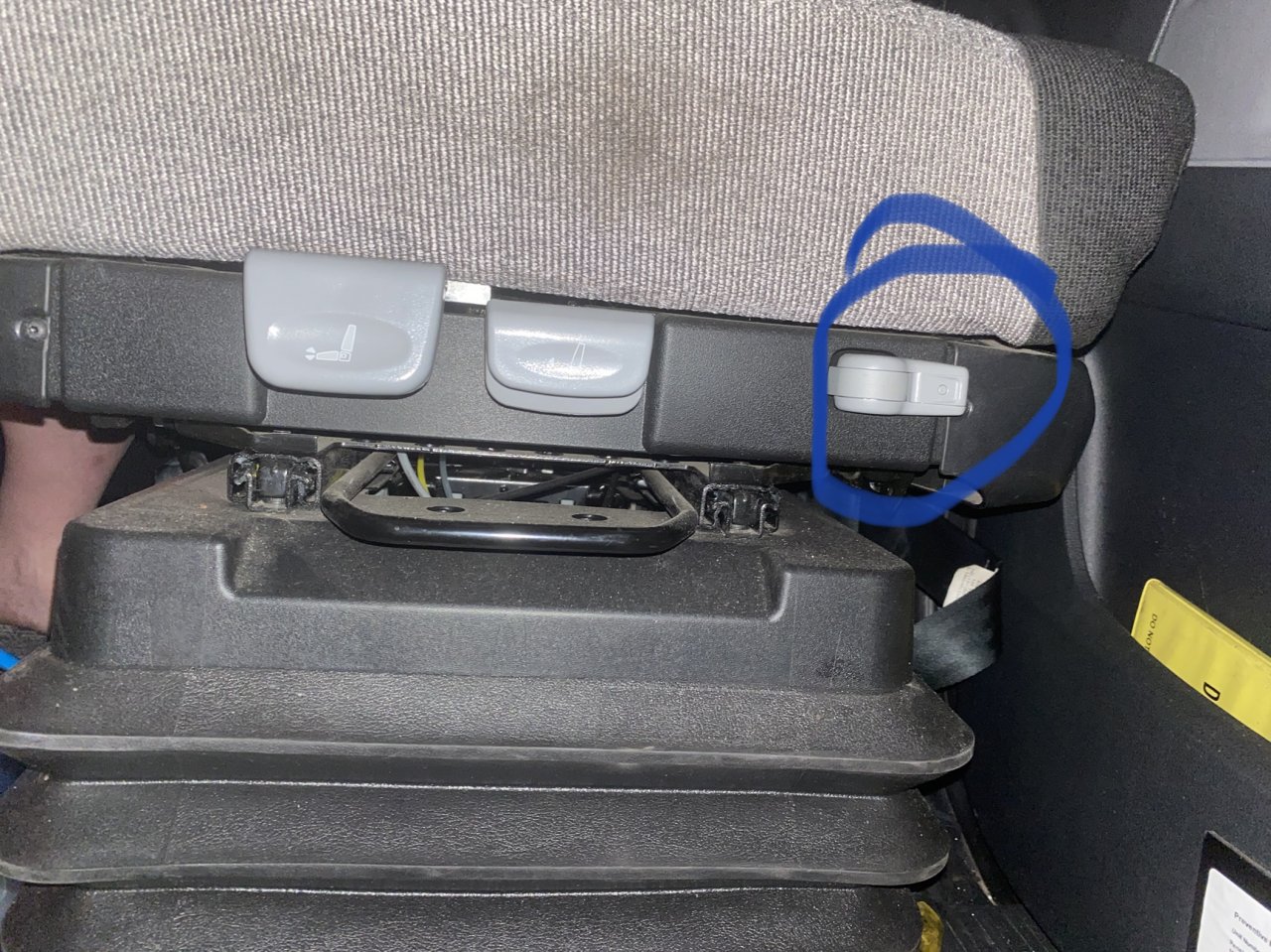

  10. ncmickey
    ncmickey Road Train Member
    3,746
    6,786
    Jun 21, 2013
    Durham NC
    this one, circled in blue
