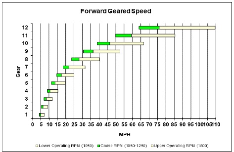

    MP8-445SE HE / 1860, std M12 OD, 2.47 rear on lo-pro 22.5, 235" WB, full aero kit, 250 gal fuel. Avg MPG is mid 7's. Reefers, usually heavy, usually north/south lanes over the Appalachians, running the speed limit.
    If I did more flat land and slowed down some, that average would easily be 8+. Late summer I happen to get 3 weeks in a row of light-medium loads and was running 7.9 avg.
    Chart shows gear/speed chart with sweet spot highlighted for this spec.
    ETA: The chart is a little misleading. Loaded RPM is down to about 850. On gentle hills where it loses speed on the uphill, it won't do the 12 to 11 downshift until around 58 mph. If you start climbing something steep, it will downshift closer to 60 mph. I also have the predictive cruise that I believe is tied into the GPS that may also play a factor on how soon it shifts on hilly terrain.
