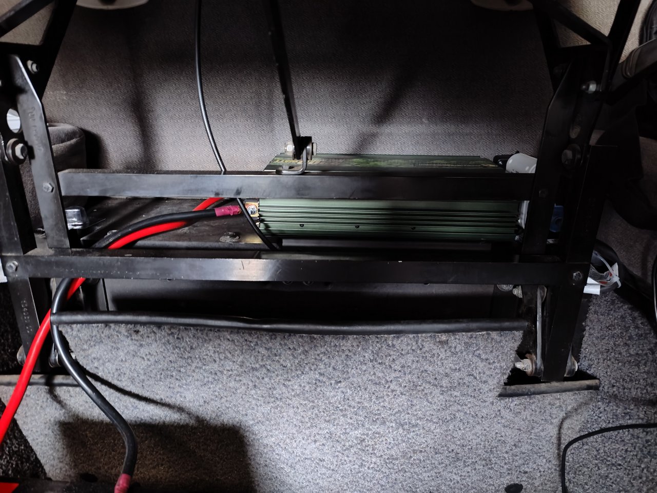

    What tank did you go with that is DOT approved?
    What inverter do you have?
    I have a Xantrax with the built in 55amp charger, it does all I need it to do, I'm looking at the Cummins Onan 4500 watt generator, it will do 18 hrs on a tank and has a remote start
    Also, where did you put your generator and what did you do with the exhaust?

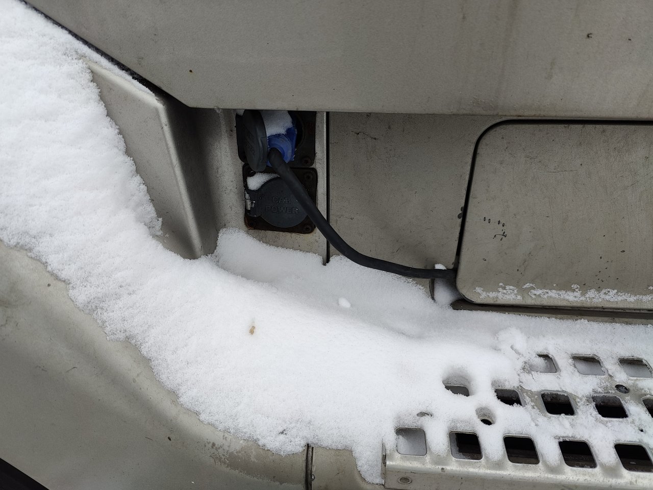

    20 minutes with a block heater like this style makes a huge difference.
    I know this pic isn't one for a 15 liter but you get the idea

    I have the same setup as the op, mine is 2 200ah batteries, block heater tied to that, and haven't had a problem doing it.
    although I took last week off and didn't have to deal with extreme temps up here. If it is well below zero though I iwll just idle the truck for the night.
    I am also waiting on a webasto coolant heater, then the inverter will be used for my heated blanket and whatever other electronics I run
