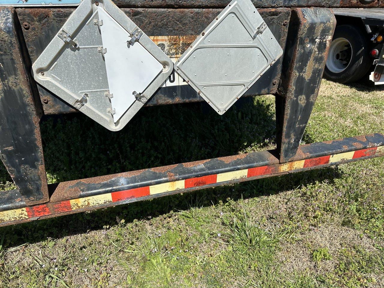

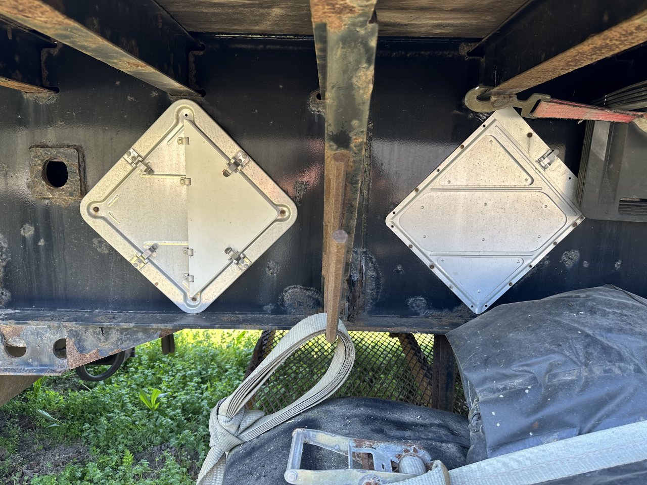

Rear - screw or rivet in
Sides - screw in between all other boxes, racks and BS you have going on.

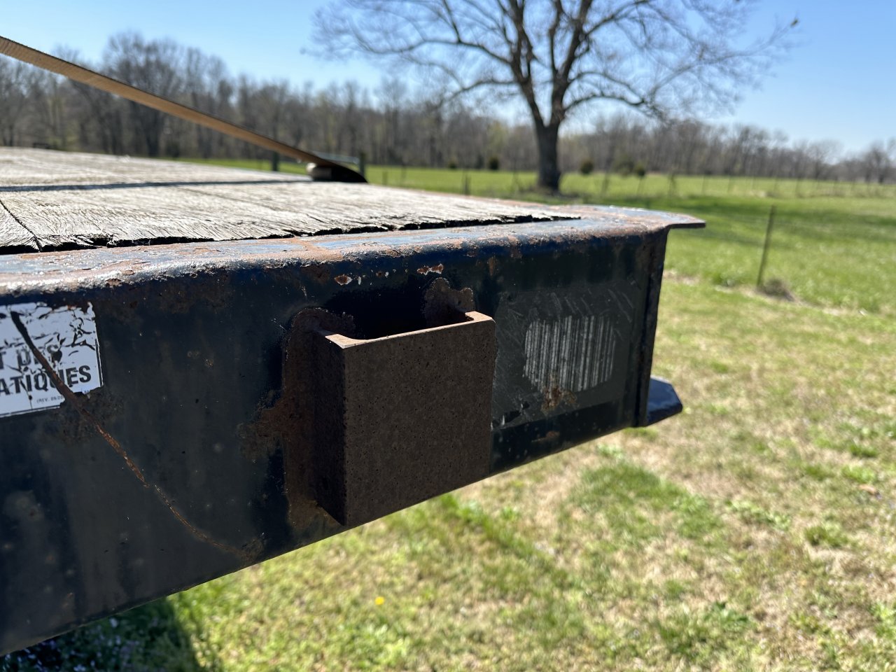

Weld a stake pocket on the front of the trailer

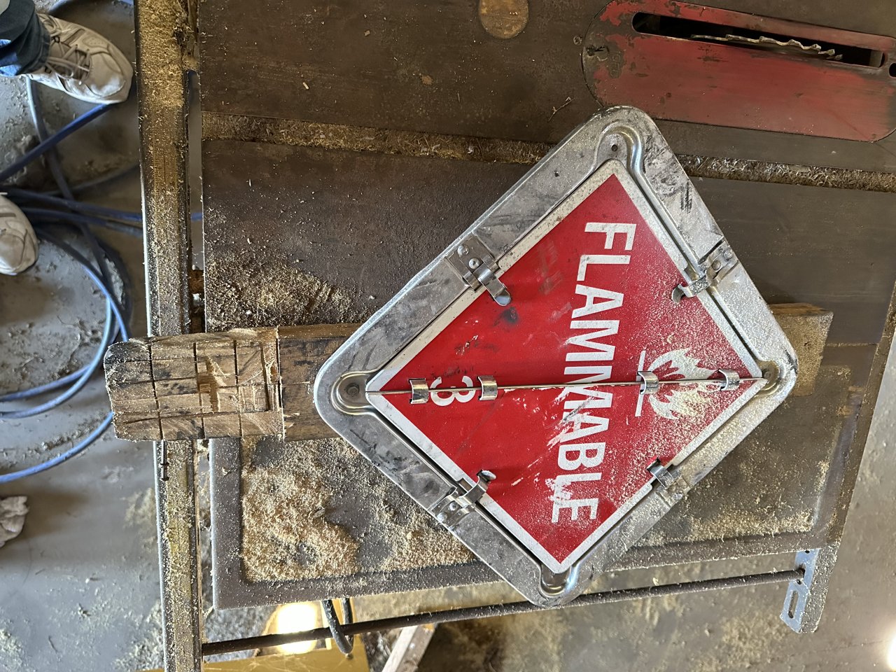

Carry a screw gun and the 'slip in' placard holder so you can change out if needed.
YOU WILL NEED the slip in placard holders and some clear plastic cover sheets to prevent them flying out/ripping etc. UNLESS you absolutely know that the product you'll be hauling will fit into the 9 classes that the flip provides.
OR you can buy the fancy ones with the 4 'rolodex' style flips that you can display UN numbers with.

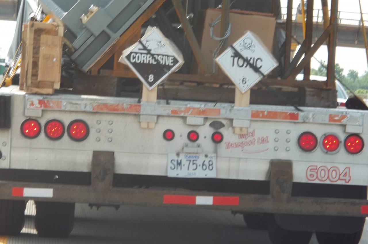

I take a placard and bolt 4 of those big OS flag magnets to it.
Stick on front of trailer right front side. Never lost one yet.
The stick in the post works well as long as the roads are smoother than the ones in Louisiana.AFC and blairandgretchen Thank this. -
I peg a nail or screw in the bottom of the stick to keep it from popping out, bungee cord works too.North Pole Nightmare Thanks this. -
