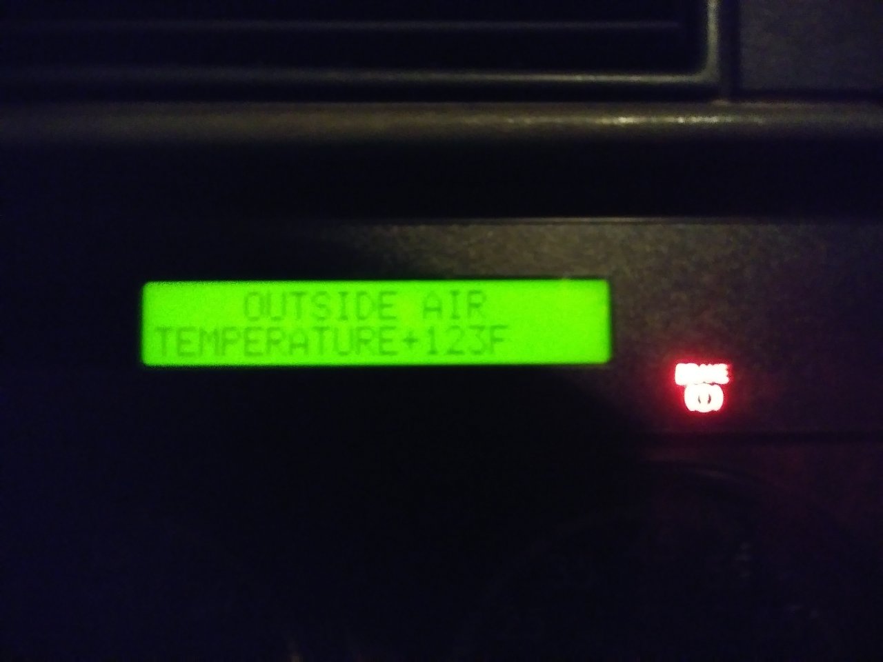

    Thanks everyone for the fast replies. The weather channel says it's 76 degrees outside and it's midnight. Had the truck off and all opened up a couple hours ago. Now I really need to get some sleep so I closed myself in and cut on the "air" (bwahahaha!). Dug out my ice alarm (never used, been kicking around in my tool collection for two years) and here's what I have after an hour with the a/c on. The air from the vents seems "cool-ish" but from this thermometer (placed on the bunk in front of me) I see it's not my imagination. It's STILL effing hot in here. I swear it was over 100* earlier today, even when moving.
    With this ELD thing I haven't worked much since April 1 so I'm hating to think of asking the guy who owns the truck to come out of his pocket for this but yeah, thanks to your moral support (and my thermom) I see that it's NOT supposed to be this way.
    THANKS A LOT and "safe travels" to you all!
    I will post an update when I get it resolved. I'd like to get back to home base tho, because everything is 2x the cost at truckstops. I don't know if I can last four more days like this.

    Does the engine fan cycle on and off? If you've got a manual engine fan switch have you turned it on and let it run wide open? You need airflow through the condensor to remove the heat or your A/C isn't going to blow cold.
    Also have you physically checked the condensor/rad/air to air to see if they are externally plugged or if the fins are bent over? Again, no airflow through the condensor = crappy A/C cooling.

    The fan doesn't cycle extra. (Like when climbing a hill in the heat.) Manually flipping the switch on makes the "outside temp" gauge rise about 5* with no diff in the a/c. I'll check out the other things you mentioned. THANK YOU!
