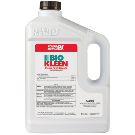

    1st time my tanks have been invaded by algae. About 1/2 of the bottom of one tank has it. The other tank has just a little on the weld seams...
    I shocked it with this ps stuff...
    16 oz to 210 gallons of fuel....that was Saturday only ran 400 miles yesterday and this morning when I fueled tanks looked exactly the same ... I put another 16 oz and topped the fuel off....
    Truck runs fine for now , but how do I get rid of these pests....?

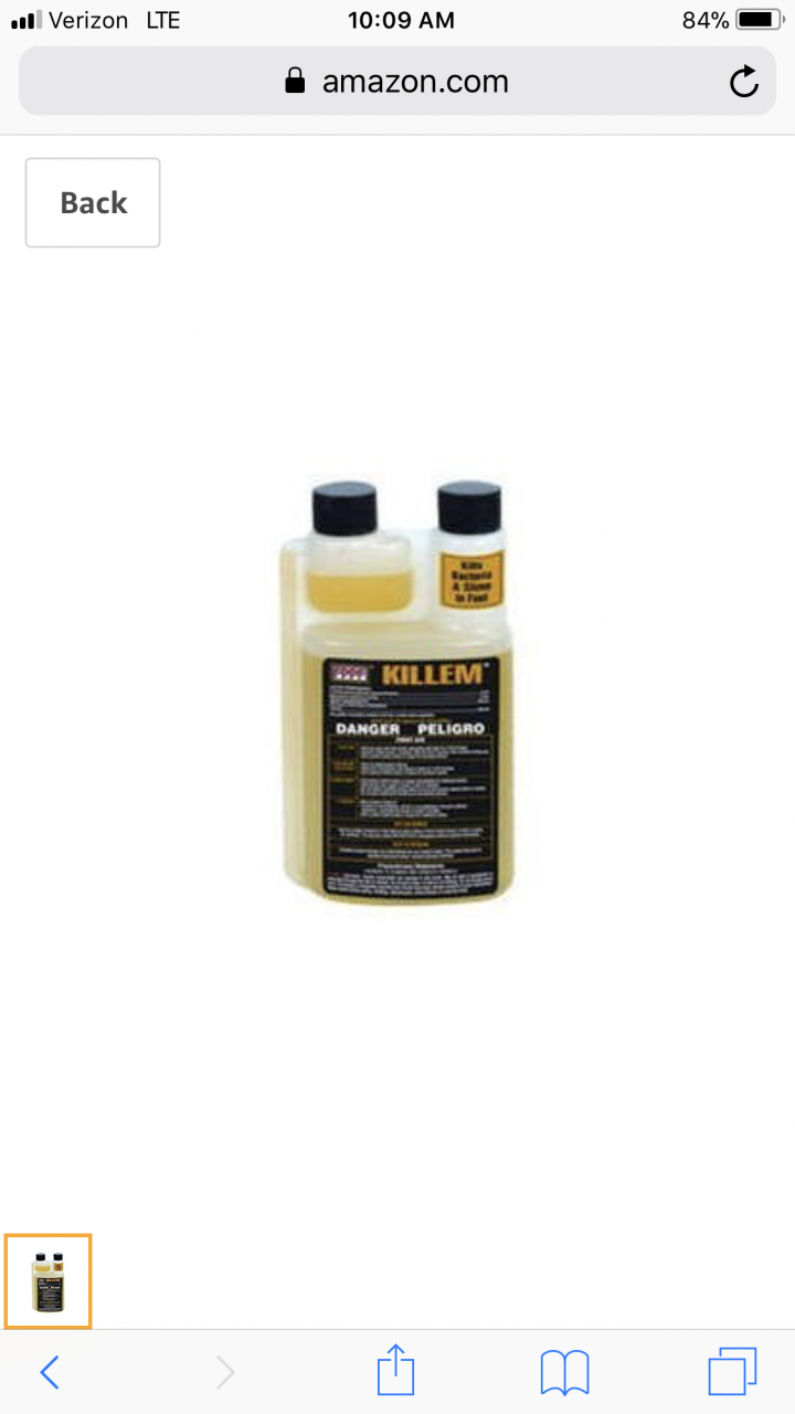

    This works much better, I tried Power Service BioKleen and FPPF Killem
