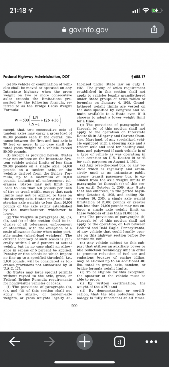

    How is that possible that a single screw can scale a front trailer at 26,000 lbs, if the axle is only good for 20,000?
    https://www.govinfo.gov/content/pkg/CFR-2013-title23-vol1/pdf/CFR-2013-title23-vol1-part658.pdf
