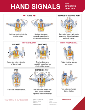

    By the way @scottied67, better hand signals next time you help out. Cross your forearms for "STOP" for starters. There's a set of hand signals used at every oil rig to help spot somebody backing. Something like the following image.
    Nothing is more frustrating than trying to do a tight back when you are getting the ubiquitous circling arm motion. Very frustrating to see a trainer impatiently waving his arm in a meaningless circle, then getting angry at the trainee for not understanding gibberish.

    I thought you only needed one signal, swing your arm like a 3rd Base coach waving the runner home. That one signal can mean stop, go, left, right, turn more, turn less, 3/16 of an inch farther, speed up, slow down, etc. ;-)

    Still using the same hand signals I used to walk 400 ton cranes around jobsites. I assure you my signals were valid, clear and accurate just they don't translate well to a POV forehead mounted camera.
    But that's why I stay on the blind side of the vehicle, mostly there to let the operator know not to hit anything. The operator is responsible for the side he can see.
    When we walked crawler cranes, we usually had a hand stationed on each corner of the rig letting the *one* main signaler up front know if they were getting too close to something.
    But I still think radios are the best signaling device.
