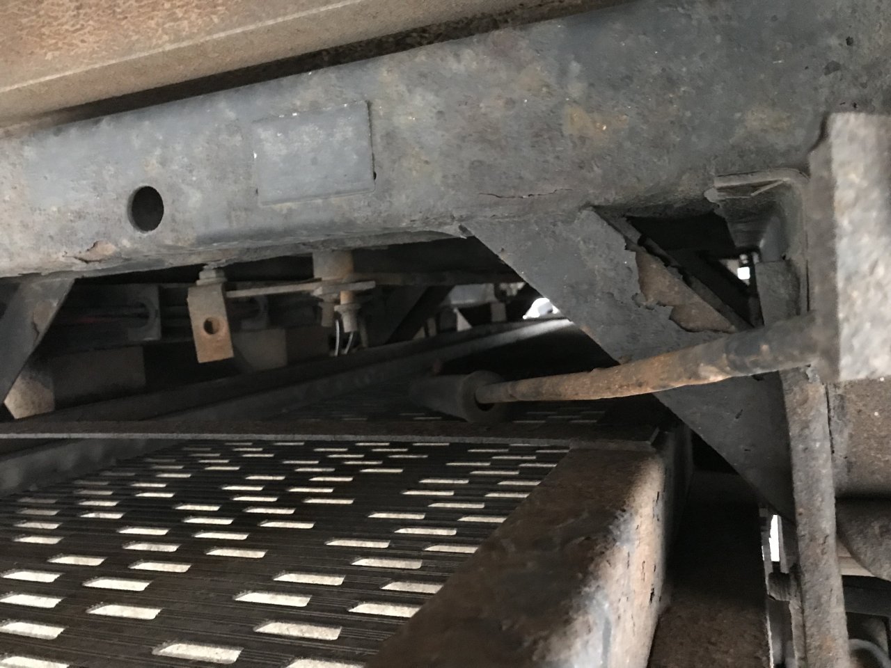

    This will also make it hard to move the tandems.
    Cardfan89, misterG and MACK E-6 Thank this.
  11. MACK E-6
    49,284
    230,807
    How long you suppose that’s been broken?
