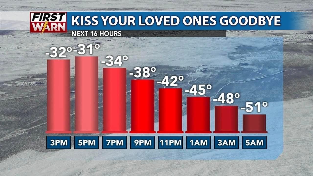

  4. Cat sdp
    Cat sdp . .
    21,180
    75,051
    Apr 8, 2012
    Orion's Belt
    Meanwhile in ND……
    Wargames, NightWind, Freddy57 and 11 others Thank this.
