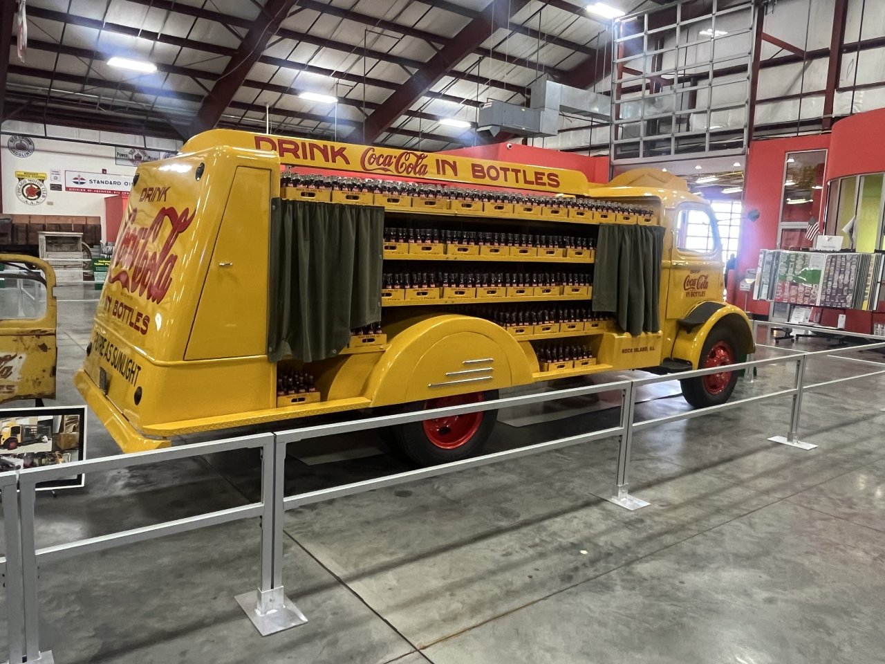

    Today the good Lord has granted me one more year of existence. Speaking about trucks today I had the opportunity or privilege for the first time in many years to stop and get to see the "I-80 Trucking Museum " I felt like a little kid!
    I reflected on how trucks and cars were built back then and how durable they were with minimal maintenance problems and cost was very low.
    Sometimes If you had a problem you would just cut some wires and continue driving or if a fuse was blown you would just take out the little pack of "Spearmint Gum" and use the aluminum foil and wrap the burnt fuse put it back in it's location and continue driving!
    Nothing would stop you from going down the road unless it was a major problem.
    Here is a couple of pictures...
