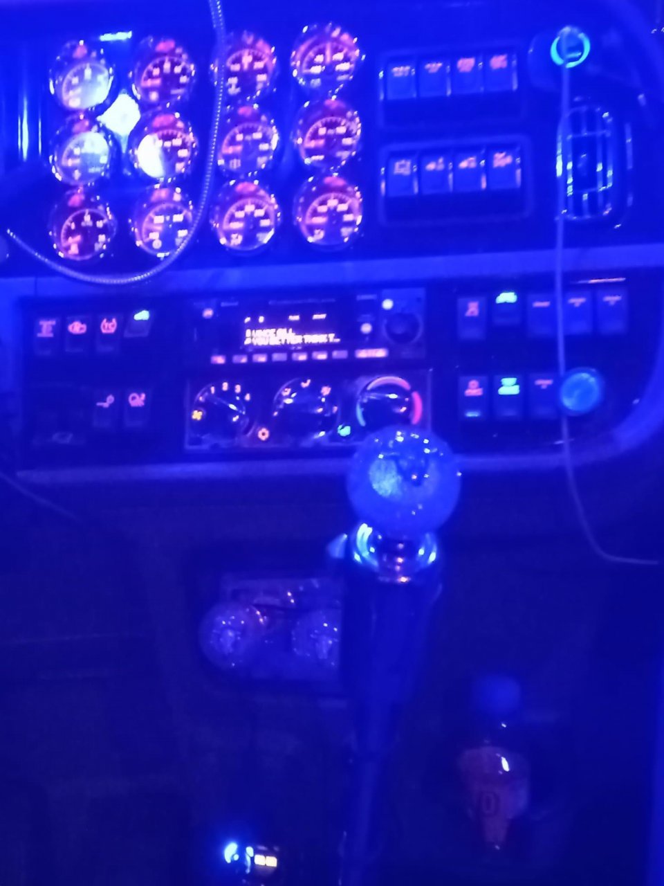

    I haven't seen anything like that since the missus dragged me to a disco in the 80s! ;):)
