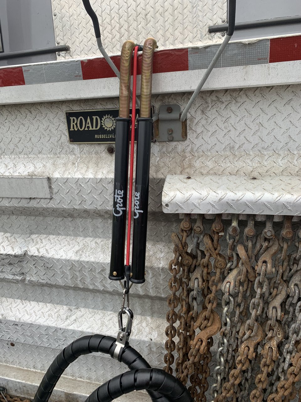

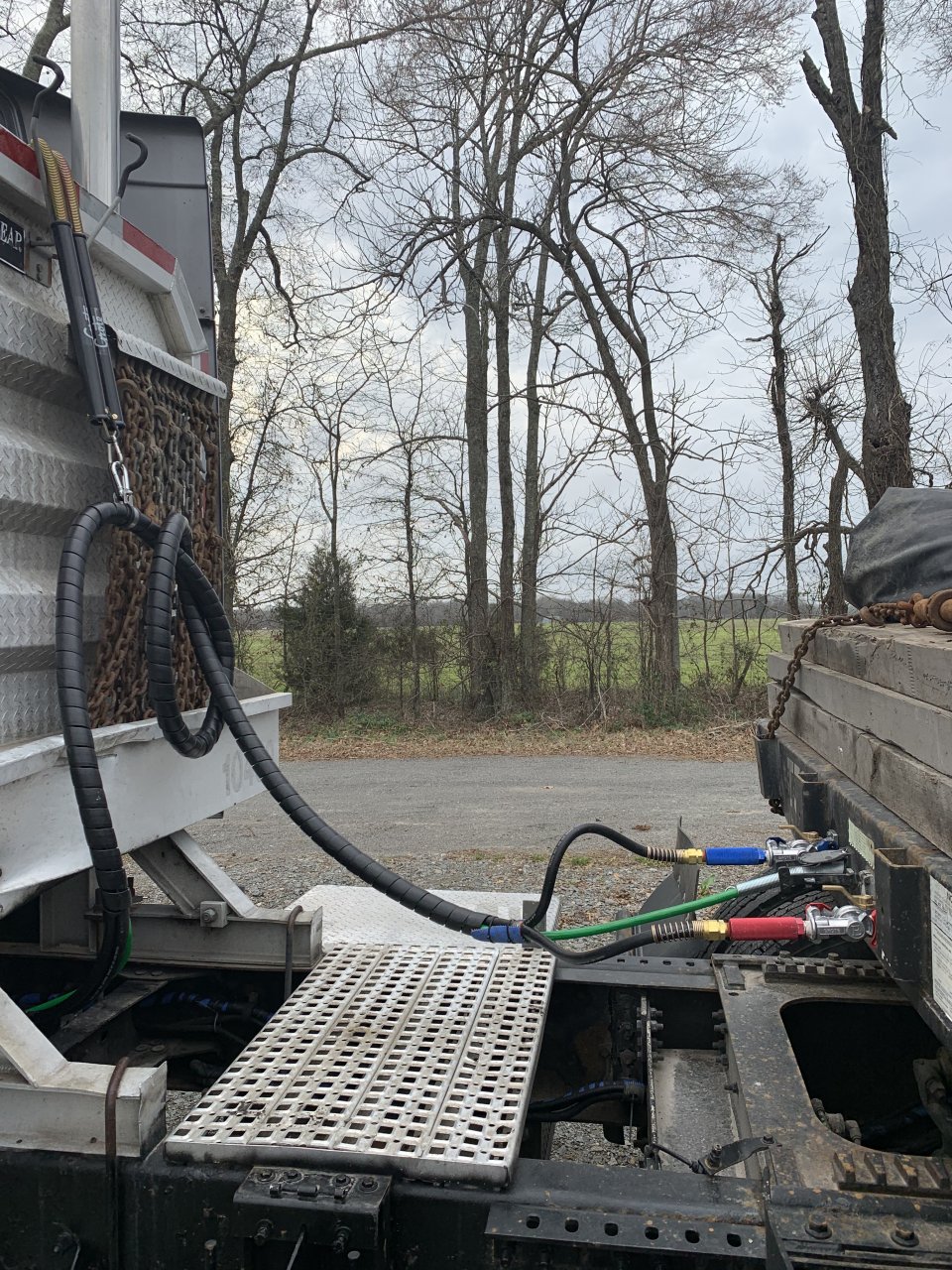

    213B761A-71EC-411D-882E-7817ED344BF2.jpeg F7CDC1D4-8E5D-4541-96A8-072D091105E4.jpeg Ok, so how does this look? It finally warmed up a bit and I got my pick up truck job finished. I tried the loop method, and added the red bungee cord up there to help support the weight on the springs.
    That little blue coolant line I got wrapped around, I’m probably going to change that to a piece about a foot and a half long so when it slides the lip won’t catch the cat walk.
    Only problem I see is maybe that knot getting tighter with enough pulling going on

    That looks like it will work Okay, but I would take out that knot, and connect a second spring on the top of the second loop. Using a bungee as a long-term load bearing vertical support would have me constantly worrying about it.

    Get another carabiner clip deal like you have. Take the knot out but keep that loop and use the clip to hook it to your existing springs.

    Ok. Yea with that second spring, the weight distribution could be better. The bungee is barely being tugged on but relieves the springs a bit, I’ll check that out!

    Ten4. I see what your saying. I guess I took the loop method a bit to far lol. I’ll try that out. Thanks !
